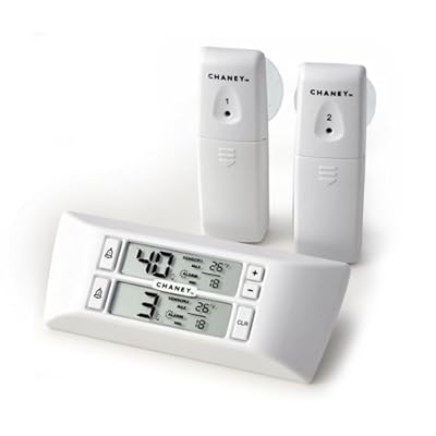

BTW, here is what I have for keeping tabs on the fridge temp.
[ame="http://www.amazon.com/Chaney-Instrument-00985-Refrigerator-Thermometer/dp/B000P55SN4/ref=sr_1_20?ie=UTF8&qid=1303147841&sr=8-20"]http://www.amazon.com/Chaney-Instrument-00985-Refrigerator-Thermometer/dp/B000P55SN4/ref=sr_1_20?ie=UTF8&qid=1303147841&sr=8-20[/ame]
It's a Chaney Instruments wireless thermometer with 2 sensors, one for the fridge and one for the freezer(or you could stick the other one elsewhere). It allows me to keep an eye on fridge status when driving, while siting at my desk at work, or when in the camper without ever opening the door. You can set alarms for high and low extremes and was only about $30. So far it has been great. I'm going to put velcro on the back to attach it to the truck dash or the fridge door.
