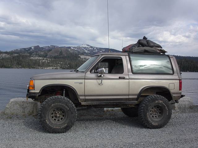

5½ foot Francis whip w/spring on a triple-mag-mount. The spring keeps trouble with tree branches at bay.
