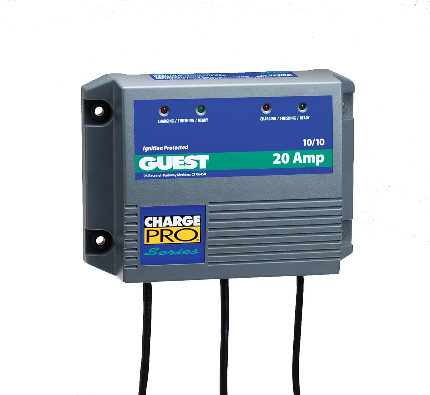

This is how I charge my trailer battery, I also have a marine grade battery charger I use when the trailer is parked at the house.
dsc02832-jpg.121295
Inside the the nose box this keeps the batteries topped off. in the trailer for 8 yrs and not a problem with it. 2Groupp 31 AMG deka batteries gong strong.
