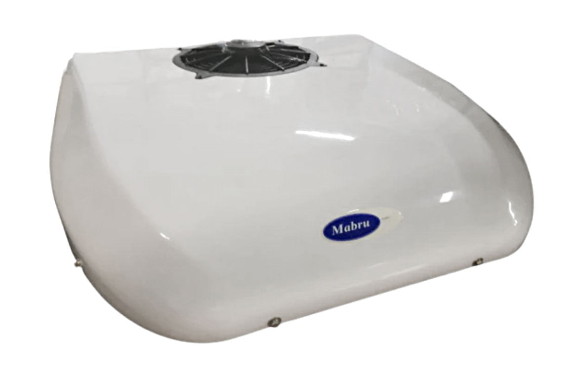

looks like the 12v unit I’m leaning heavily towards does have a condensor, unless I’m reading this wrong.
Every a/c ever built has a condenser (and an evaporator). The major efficiency increase of the latest ac models is the use of inverter motors which are able to maintain high efficiencies at low motor speeds (where they spend most of their time) as well as high speeds.

Doh, you DID say an inverter motor. Sorry about that!
Looks like the Mabru does also include an inverter. Van Life Outfitters did some tests on both electrical draw and db levels in operation, independent of what the manufacturer states in their literature.
