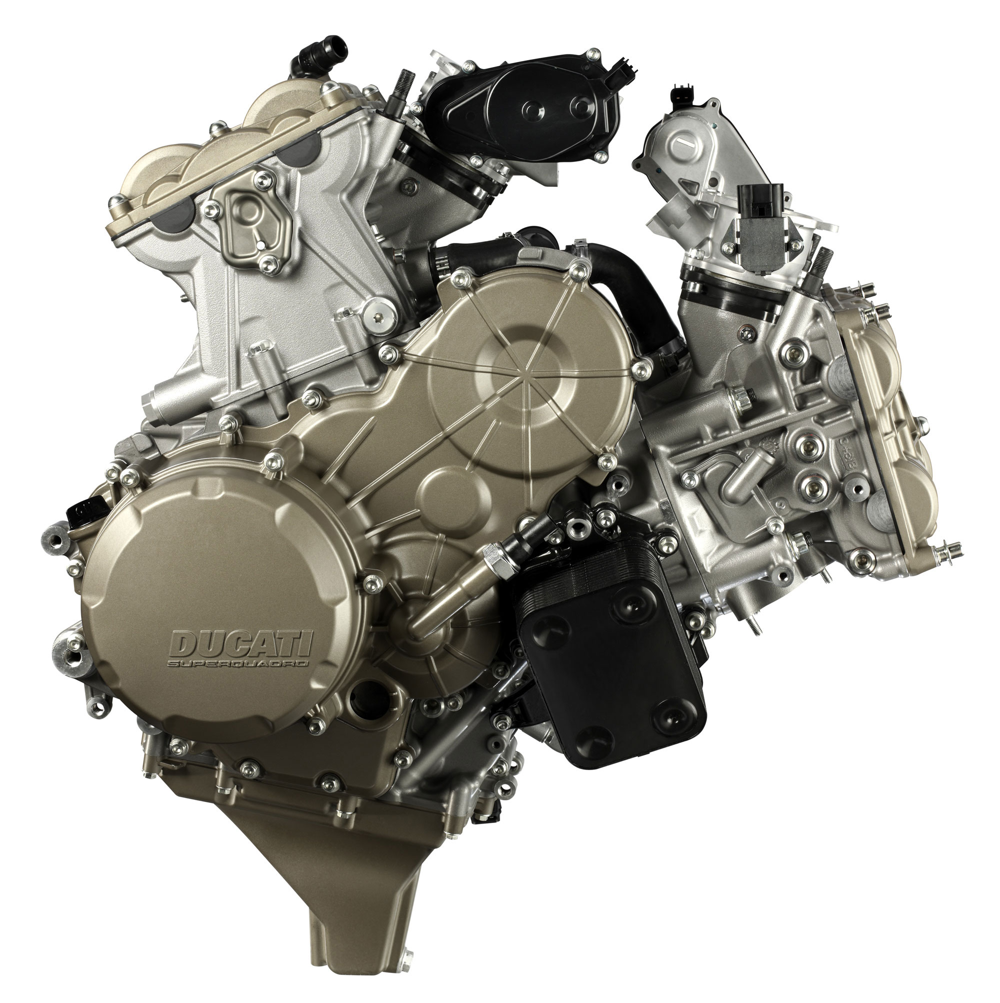

Shape has a ton to do with it as well. A really deep, narrow sump is fine up front. If the Taco sump is similar to this Superquadros, having it at the front is fine. You'd have to be almost upside down to not have oil in this sump. Being that just half a quart puts the sump way under the oil level.
