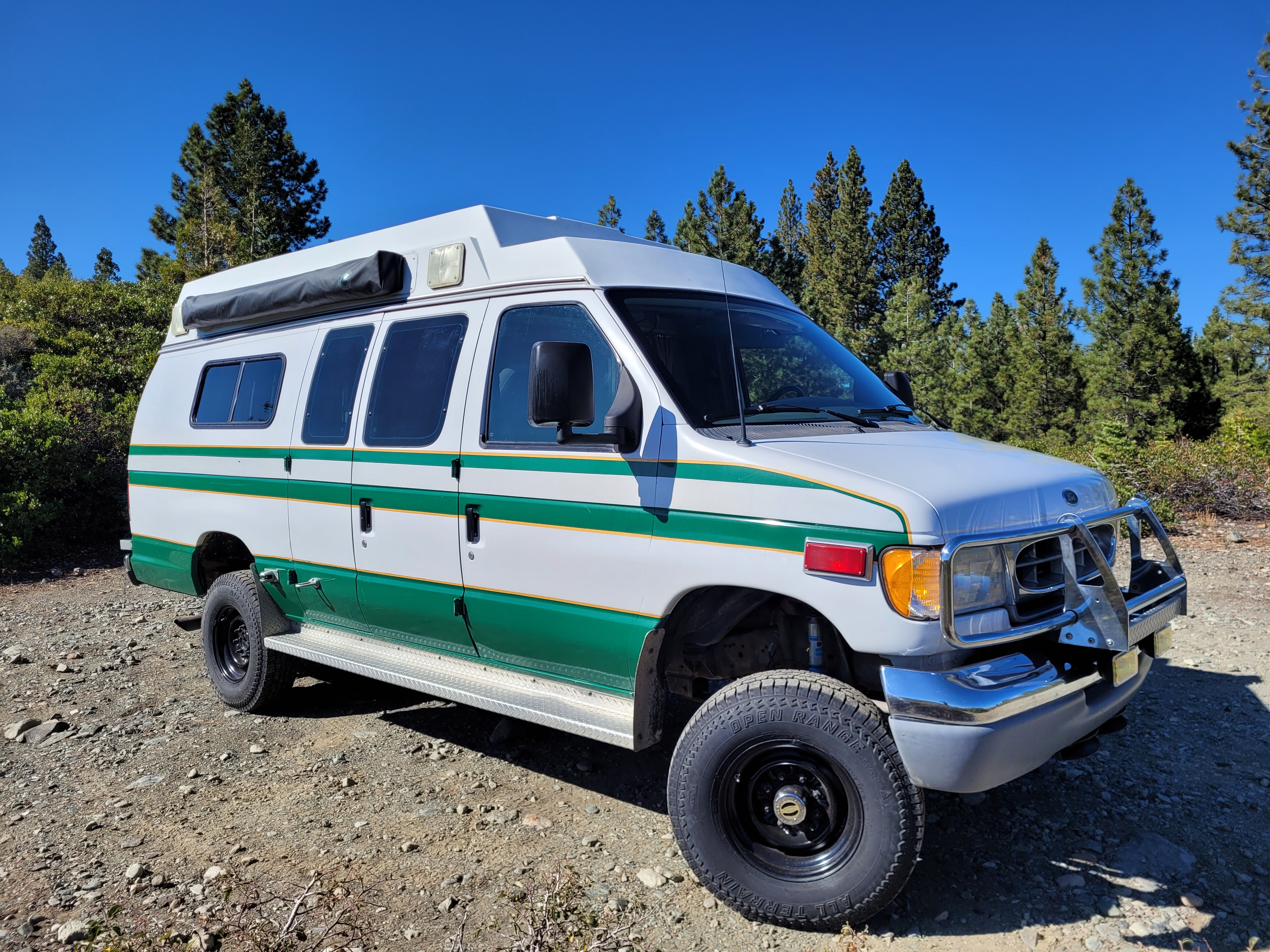

2002 Ford E350 7.3L 4WD Ambulance Adventure Camper High Top
Condition: Very good with no rust
Mileage: 179,000
History: This ambulance was acquired from a small local hospital in the area. The hospital purchased the van from Ford and had it sent to Leader for the conversion process into an Ambulance. A 4WD package was then installed by https://whitefeather4x4conversions.com/ and it was used as a fleet vehicle and was very well maintained. I bought the van 2 years ago to utilize it as a tow vehicle for our Airstream. We no longer need it as a tow vehicle so I converted it into an adventure camper.
Exterior: This vehicle comes with fully operational emergency exterior Flood Lights (driver/passenger/rear), High intensity flashers, Sirens and the Exterior Loudspeaker!
-New ceramic headlight housings and relays for brighter 80/100w Hella headlights.
-New Hella fog lights
-New front windshield
-Rear view camera touch screen
-Aluminum ladder for roof access
-Sliding window with screen installed on passenger rear
-Port hole window installed on driver side
-Curt Hitch with 2" receiver with dual style plugs and tow package
-New Rockymounts bike rack http://rockymounts.com/products/monorail-2-.html
-OVS Nomadic 180 degree awning https://nomadicsupply.com/overland-v...ng-180-degree/
-Tires and spare have plenty of tread (75%)

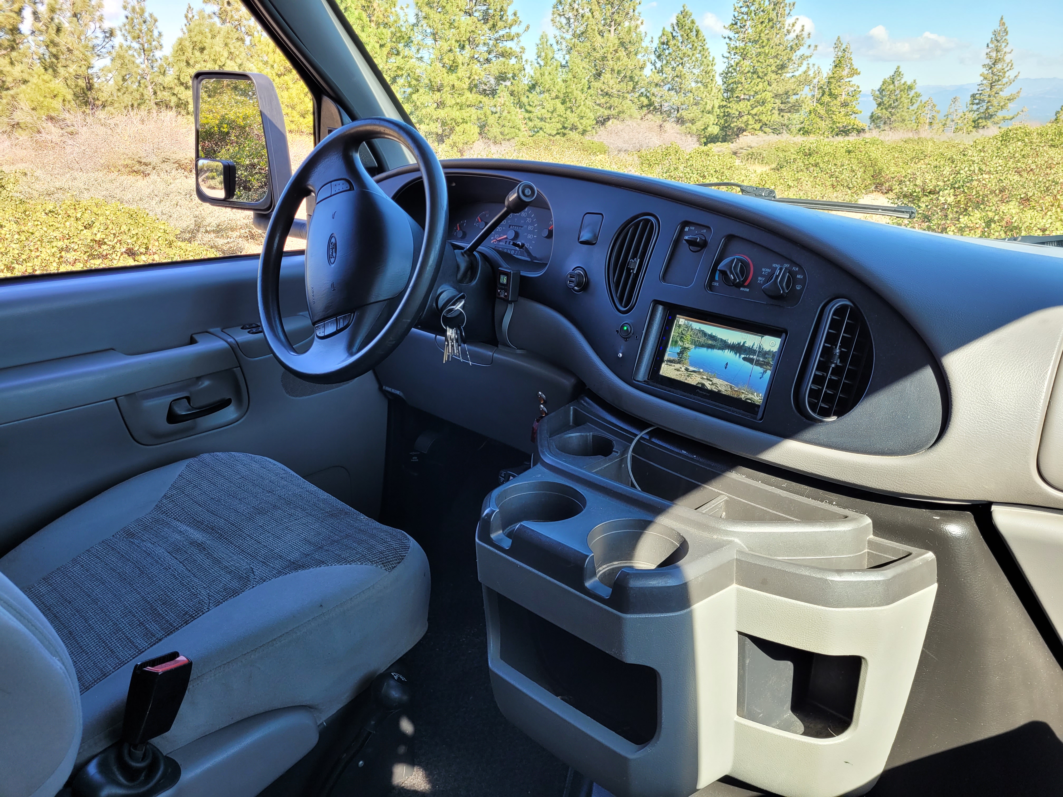

Front Cab: The interior has been returned to stock but still retains all overhead Leader Ambulance components.
-Air conditioning has recently been serviced and blows cold
-Pioneer Touch Screen Receiver https://www.pioneerelectronics.com/P...EX/DMH-2600NEX
-Tekonsha Prodigy P3 Brake Controller https://www.tekonsha.com/product/901...l-proportional
-Power Windows and Locks
-Heated mirrors
-Cruise Control
-Extended Power Mirrors for towing

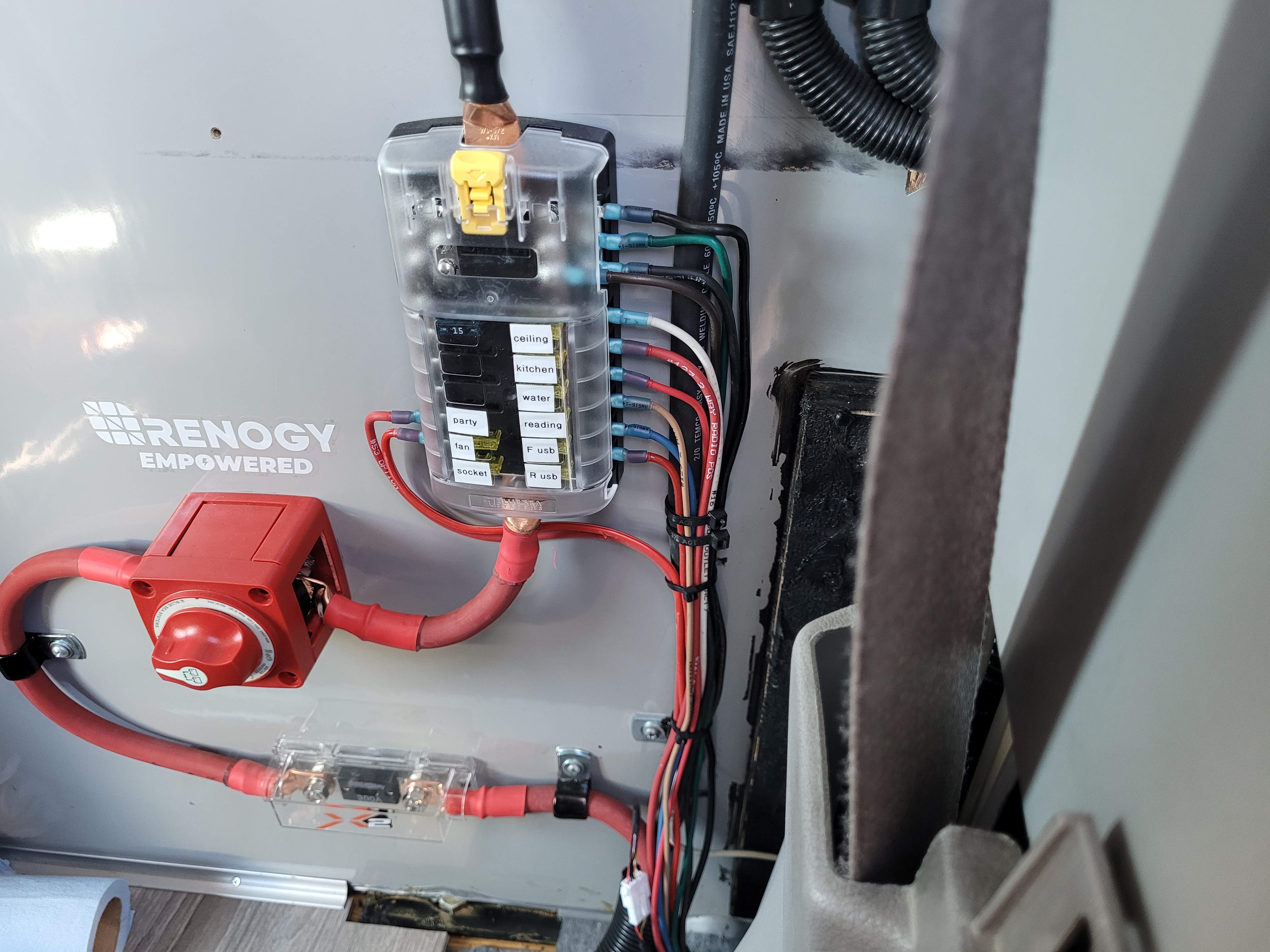

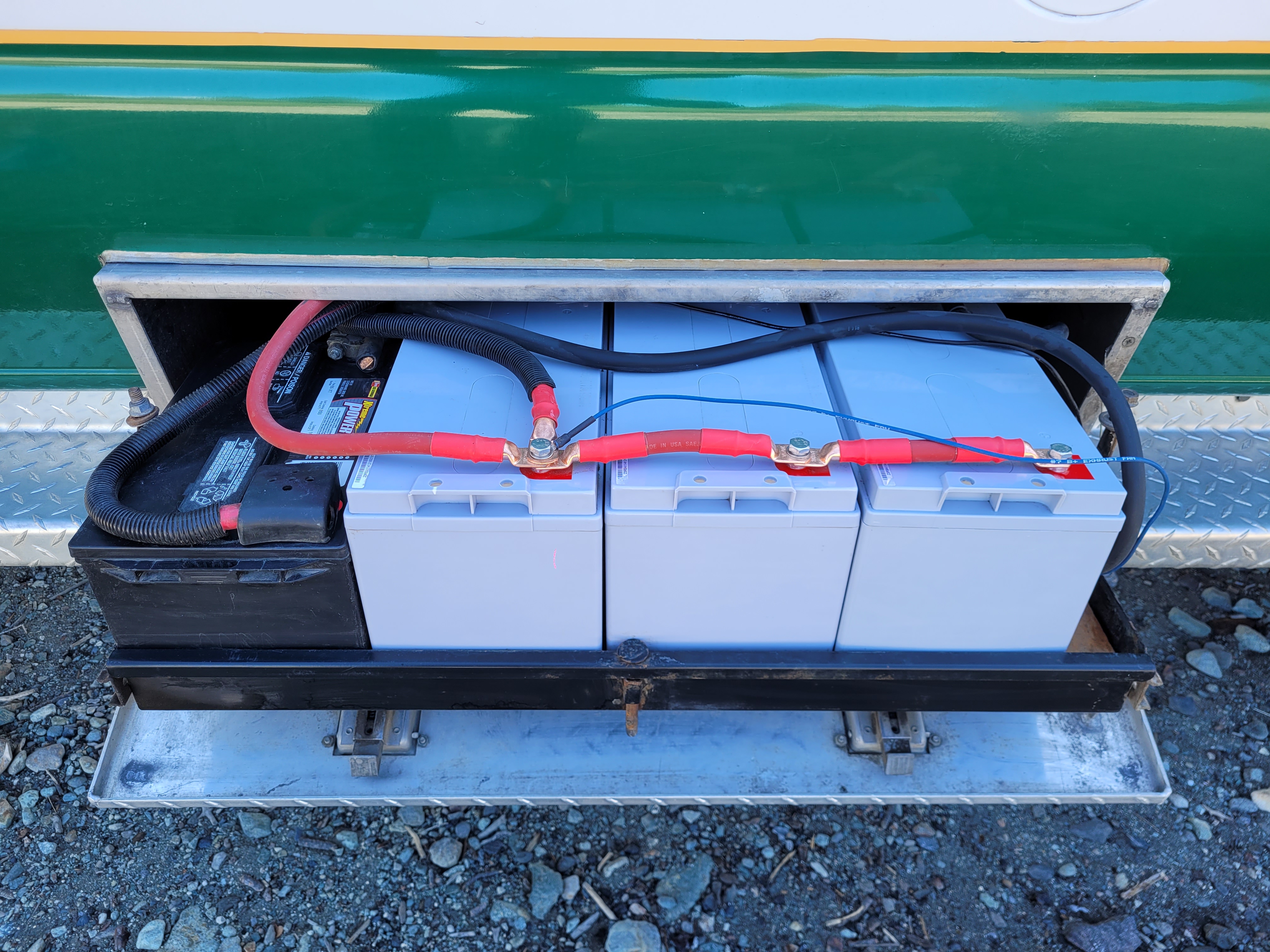

House Battery Setup: The 300 amp hour house battery setup consists of 3 new Renogy 100ah AGM batteries tied into a Blue Seas ACR, battery meter and fuse panel.
-Blue Seas ACR https://www.bluesea.com/products/762..._-_12V_DC_500A
The system is also tied into the Vanner Power Inverter/Charging System and there are three outlets that can be used to run 120v appliances/laptops, etc.
https://vanner.com/qr-20-1050cul/
There are also 2 exterior shore power outlets that can be used when available to run the Inverter/Charger, Block heater and a separate outlet that could be used for aftermarket applications.

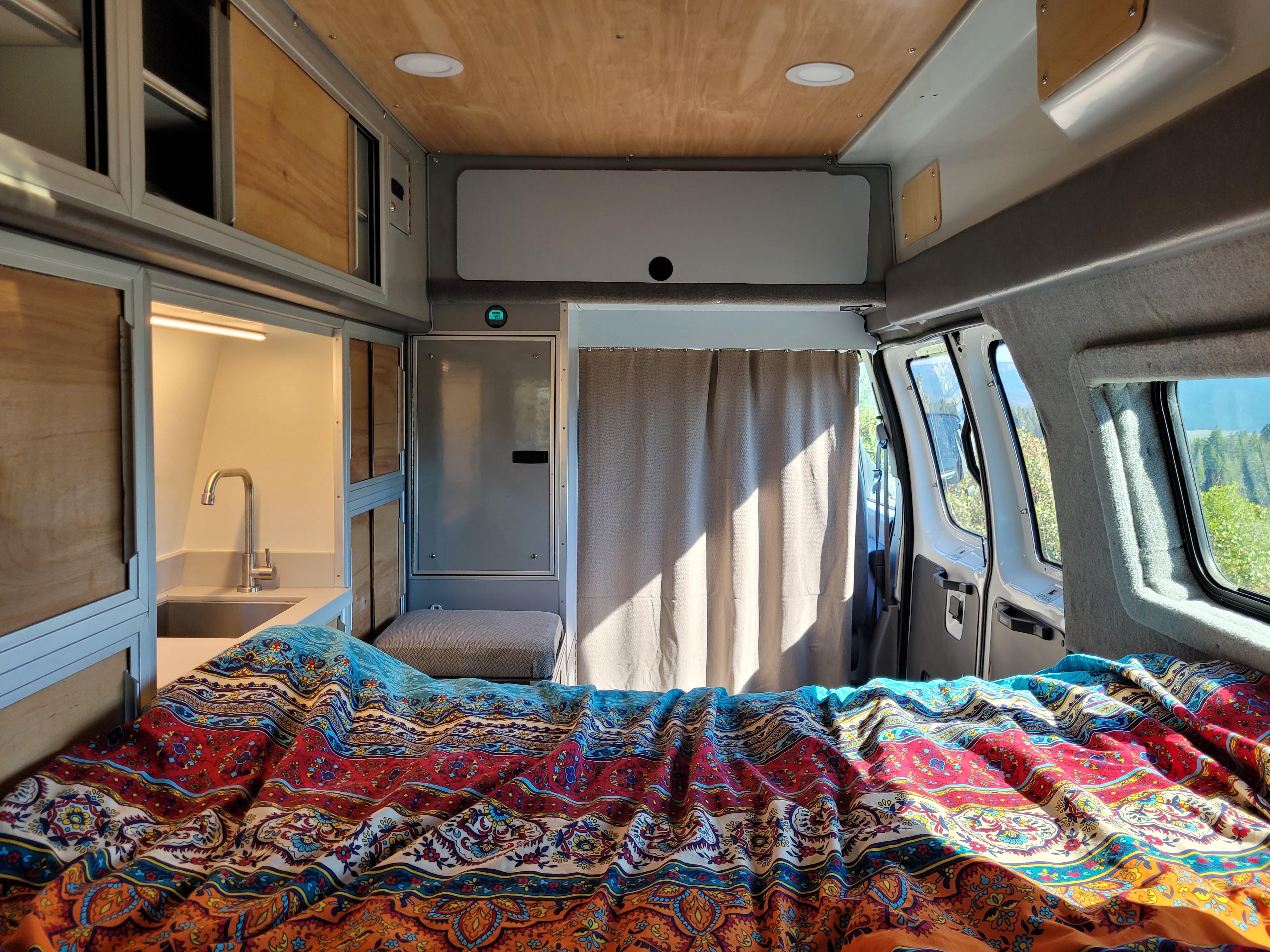

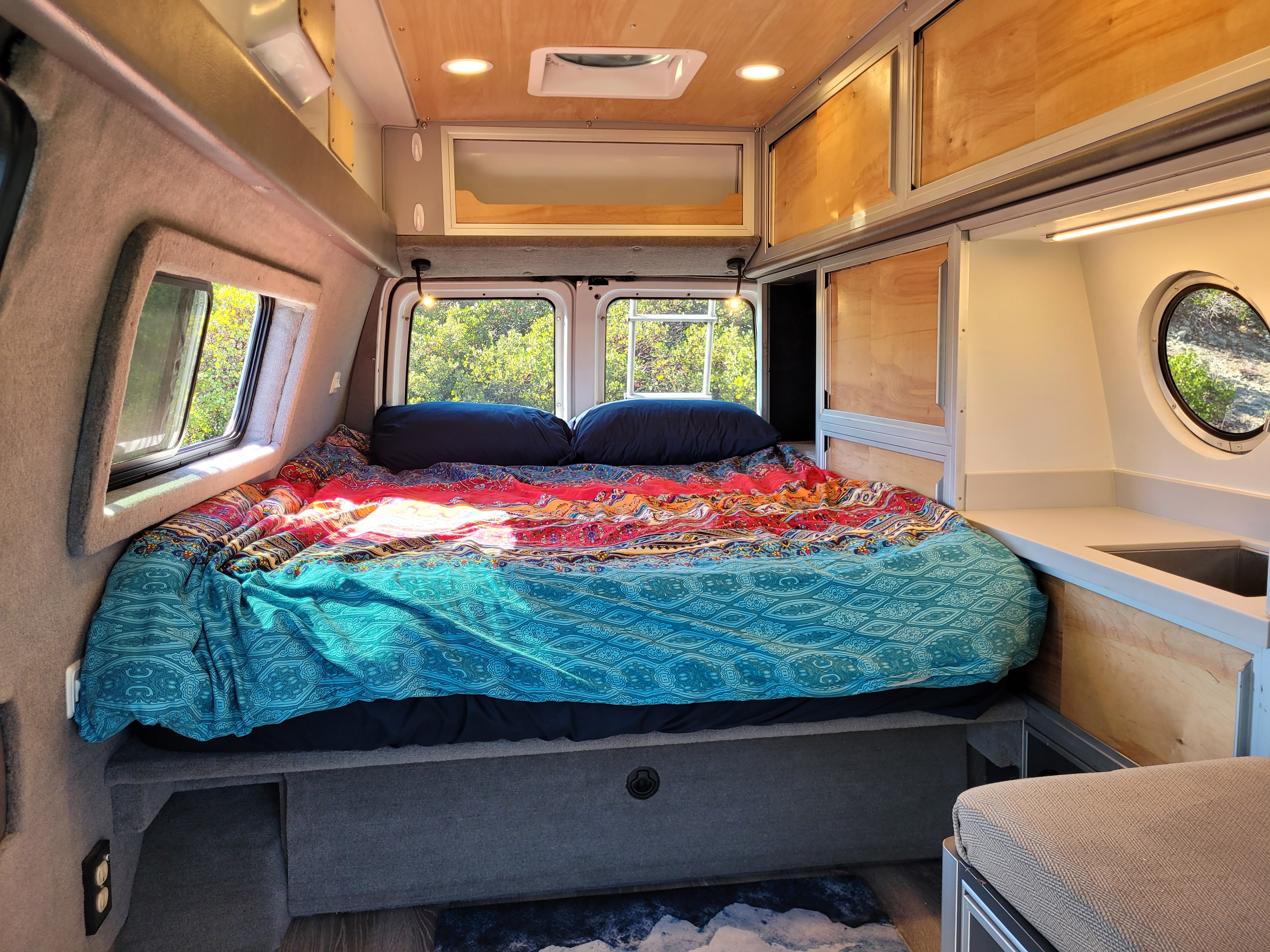

Rear Interior: The rear compartment was converted into a camper with new floors, a new custom mattress with foam topper and plenty of storage in the re-purposed ambulance cabinets.
The rear "paramedic desk" was converted into a kitchenette with and overhead light, stainless steel sink and running water from a electric Shurflo pump and 10 gallon water supply.
-A 10 speed MaxxFan Deluxe with remote was installed overhead and works well to cool the cabin. https://www.maxxair.com/products/fan...uxe-00-07500K/
-Overhead LED cabin lights
-LED reading lights with charging ports
-2 USB charging stations
-LED multi-color lights with remote control for any mood.
-Cigarette Lighter charging port (which we used to power our ARB Freezer/Cooler)
-The large drawer under the "Paramedic Jump Seat" was left as storage but if desired it would be an excellent location for a composting toilet.
-We also didn't install a permanent 12v fridge because in our experience we often wanted to take our ARB cooler with us outside or to alternate camping setups. There is a tall cabinet that would be able to house a TF65 Truck Fridge if that's the route you wanted to take.

Awesome build- Did you make new slider panels ( cabinets) or cover the glass with something. Really makes it look great less operating room
Ambolorian
Thanks Cummins!
Exactly. I removed the smoked plexiglass cabinet sliders and replaced them with wooden sliders to make it a warmer environment.
Did the same with the ceiling.

Here are two pics of the jump seat in the back. And there is a lap belt at the base, but hard to see in the photo.
I was contemplating re-purposing the large drawer underneath into a composting toilet.. but some folks don't like to poop in their rig so I figure I'd leave that up to the buyer.
If someone is interested in the van but would like some customization (composting toilet, camping package with leveling blocks/table and chairs, etc.) I could put something together.
Let me know!
