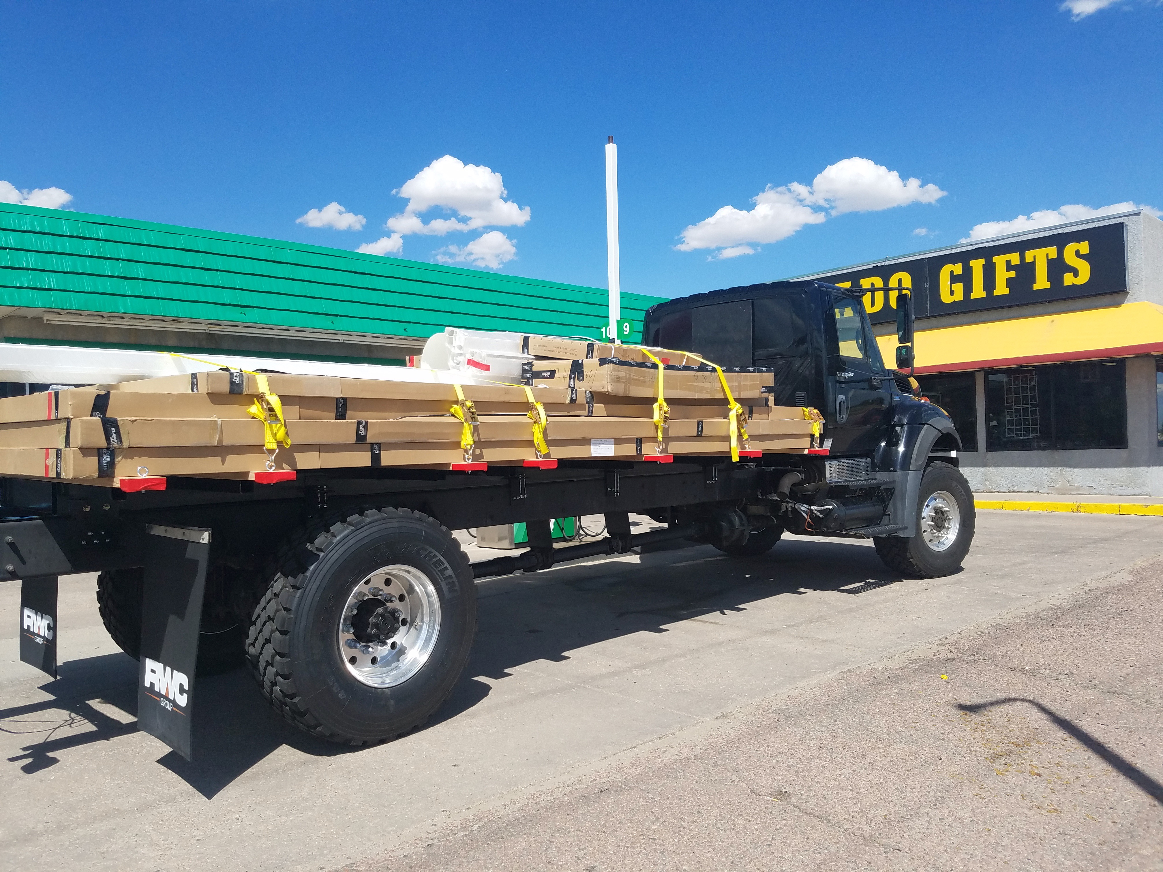

I opted for the KISS approach and went with a rail-on-rail subframe. It is a simple, proven and low maintenance design. I like that it does a solid job of keeping all 4 tires on the ground, contributes little to overall height (keeping the center of gravity low) and has essentially no moving parts to grease or maintain. I also like that the vast majority of the time the weight is evenly distributed along the chassis rails, that is until it is time to go to work. Then, as it maintains a flat sturdy platform for the habitat, it favors one rail over the other while allowing the truck chassis to flex.
This system is also commonly used for tanker trucks and has similar characteristics to a dumptruck. It is fixed in the rear and allows for the rails to increasingly separate towards the cab.
It is very difficult to see the system with the storage boxes mounted so this older picture will have to do. It was taken the day I brought home the Total Composites panels back in 2016. To save cost we shared a shipping container with a guy who was building on the unimog platform. The video of us leaving camp does a pretty good job showing the system in motion.

Why fixed at the back? I'd think fixing at the front would make the pass through easier.

The frame spec is based on desired capacity and specialty loading requirements. RedRover’s frame is standard for 27,000 GVWR... single channel, standard dimensions and strength. Additional frame would have only contributed unwanted weight IMO.
Fixing the subframe at the front (near the cab), which is actually about 1/3 of the way into the chassis frame (end to end) would create an additional and unwanted stress concentration in the loaded zone of the frame. When fixed at the back, the attachment is basically in an unloaded zone. In addition, during frame twist when the weight of the cab and engine leans one way, the weight of the habitat leans to the other side, helping to keep balance.
