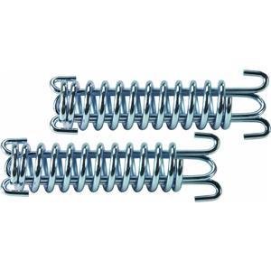

I want to make a set of four tie-downs for my Palomino 1200 TC.
I'm looking for four heavyduty compression type springs. Where can I source these?
I want to make something like this, but much more heavy duty. Other than buying Torklift devices, is there another option?
Rbertalotto
Thank you very much! Once I realized they are called "drawbar" springs, there are dozens of sources.
But at $25 each for a 300 pound spring, I might as well buy the Happijack or Torklift products for a few $$ more.
With a 1200 pound camper and not doing any "rock crawling" , I'm thinking my "shock Absorber" version might be plenty good enough to simply keep the shock off the tie down points.
With my last camper, back in the 80s, I simply tied it down with turnbuckles and chain. And I did some serious off roading with that camper..........maybe that is why it fell apart after a few years....:Wow1:
