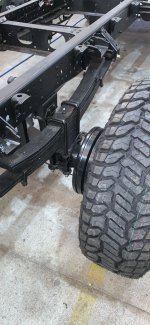

These are the ones that come as standardIMG_2193.jpegAt first glance it seems that the thickness and width increase, I am unable to understand the angle.
Enlighten me...

What do you need to see then ?
They look just like standard springs but a slight difference in centre bolt to rear eye measurement . If you look at the shackle end of you springs (the movable end). On standard vehicle the shackle pretty much is straight up and down. When you hit bump the force is applied to the chassis (straight up) because the shackle can't really move at first then flips back at the spring eye. If the shackle has a slight rear angle at the spring eye (The bump you just ran over) doesn't apply force to the chassis as hard because it can move back.
The upside to increasing set (the curvature of the spring) is increasing bump stop clearance .So said bump doesn't drive the spring into the bump stop (as well) and up your spine via your seat and posterior.
It all improves the ride (comfort) of our Cab Over trucks. Super singles I believe are a must as well. It also improves articulation when offroad, as you would have seen in some of my videos.

Thick width, extended length and length between eyelets to calculate the degree of curvature
Standard width leaf, standard thickness leaf. They (spring makers) can best measure the length from your old springs. They probably already have a listing of what you old springs are measured at in their spring manuals.
They will work out what set (curvature) is needed to achieve what you want. If you want to lift the vehicle or not / how much you want the shackle to hang back. It only needs to have a slight rear angle. This increases with load.
Going back in my threads it seems that I had 30mm added to the length of the front springs. From the centre bolt position to the rear eye. And it looks like I only had 25mm added to the rear measurement.
