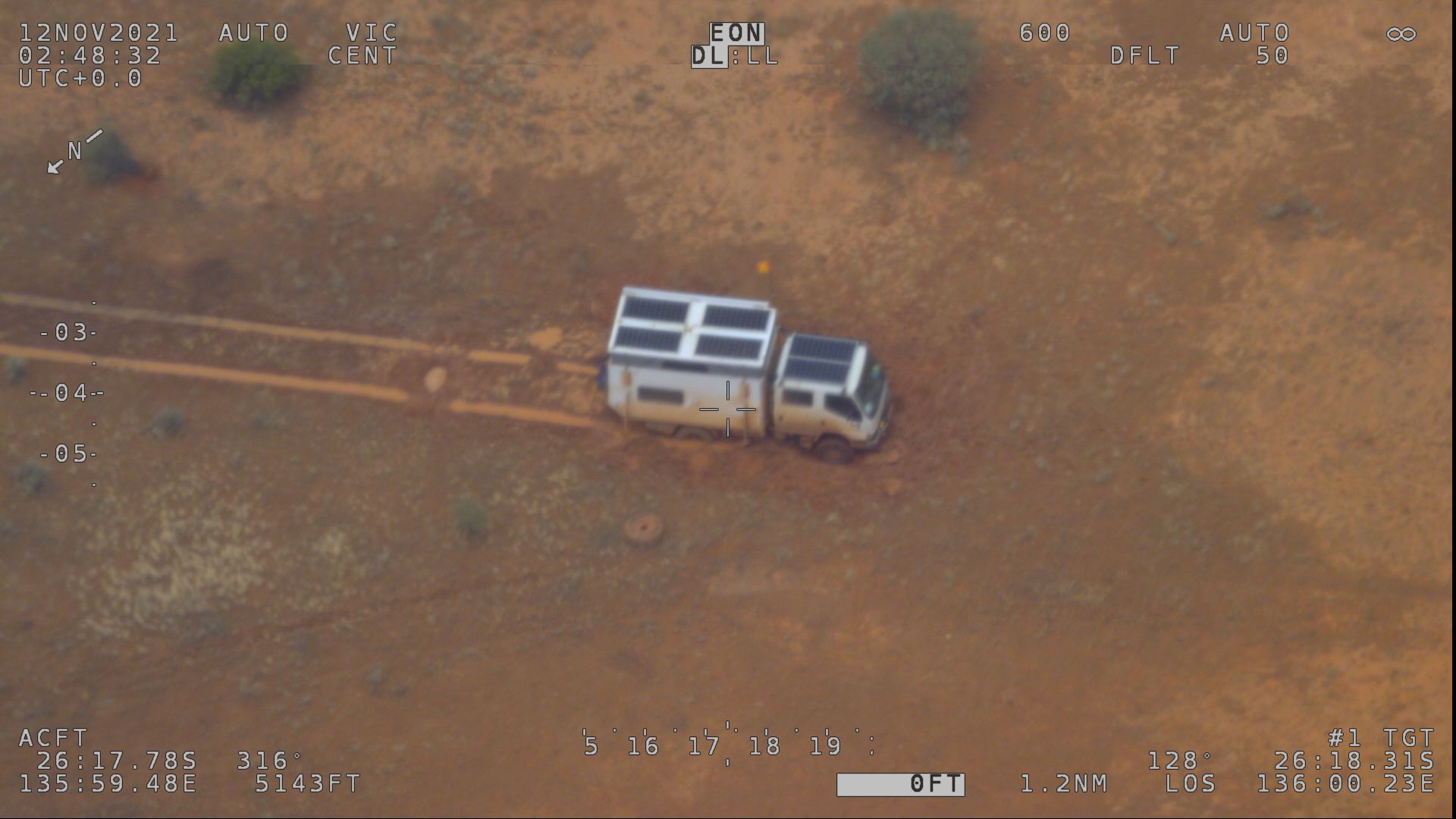

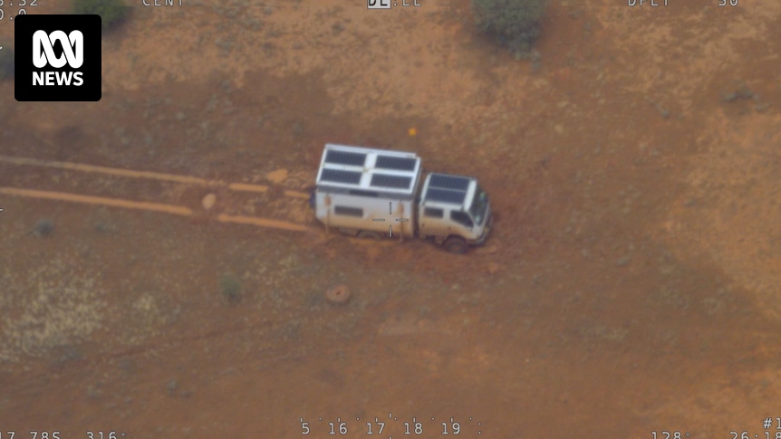

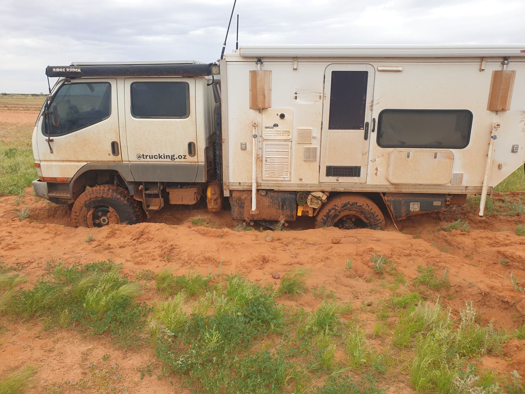

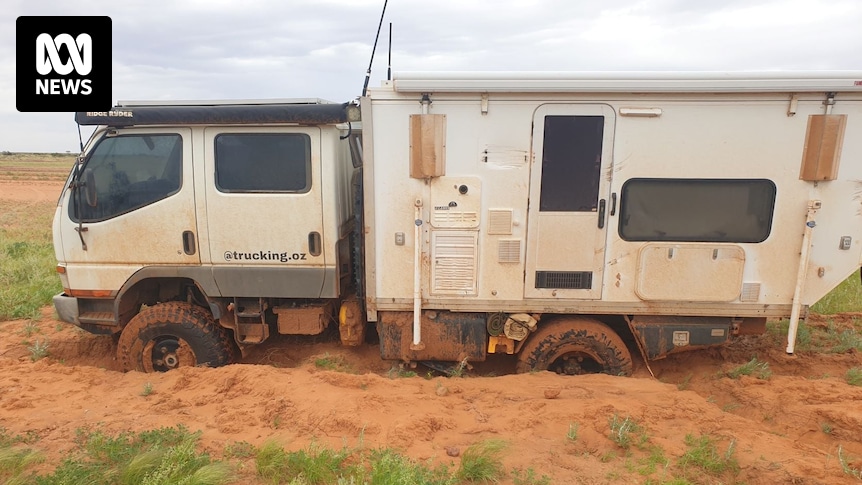

Virtually every 4WD in Australia carries a UHF radio, as do most aircraft which they also use to communicate with local police.
In the case of the news article rescue above, they also dropped a sat phone to provide long range coms to family.
