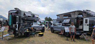

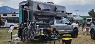

Camper Van Expo (Bozeman, MT locale) complete. Was fun hanging out in the booth on Sunday and chatting campers and pickups with folks. Was so busy chatting and looking around the show I almost forgot to click a few pics, but grabbed these right as the show closed.
