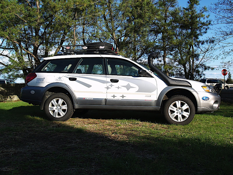

G'day Superu,
I've admired your build for some time. You inspired my 1" Kingsprings + 1" Subtlesolutions lift.
Your snorkel looks great! Would appreciate details about brand and also any photos of fitting.
I will only get one shot at modifying the guard / fender with a hole saw :Wow1:, so would appreciate any pics / advice you might have.
(As it will be on the drivers side here in Aus, I'd also be interested in any photo showing its inoact on view from RHS front seat.)
Thanks, and will continue to follow your mods with interest.

Hi Barry,
Thanks for the kind words. The snorkel I used is a Safari Snorkel for a Toyota Prado 120 series. In order to properly fit, the stock airbox had to be removed and a connector fab'd with the MAF sensor in line.
Also needed to trim a bit from the inside of the fender as seen on the left in the pic above.
I'll try to get a shot this week from the RHS interior view. The snorkel follows the pillar very closely and does not impair vision much at all for me. May be a bit different for you with RHD.
It is secured to the pillar with a section of stainless and 3 rivets.
Barry
Thanks for the photo of the engine bay and details of the snorkel.
Yes, the impact on vision from the RHS drivers position is something that I think could potentially be a problem.
There are a few Forester owners with snorkels in my area, so I'll have a close look at them, but will be interested to see a photo of yours.
