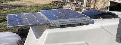

Ok.....I found this idea on a for sale add for a Toyota camper van and I thought it was genius. This should become a standard idea for rooftop solar, it allows you to fit twice as much solar in the same footprint. The bottom panel is on drawer type slides and slides out from under the top panel.
And yes.....I'm sure someone will feel the need to nitpick, etc......and I don't care. I've added this to my list of mods when I get my off-road rig.
This is my "extra 200W panel". We have 1,160W total.
Our new build will have over 2kW.

I've thought about something similar as I've tried to come up with various ideas that not only provide more solar collection but also provide more vehicle shade. My biggest concern is that having them stowed against the side of the vehicle will provide more chances for damage, but those thought may be unfounded. I'd like them to flip up and become a solar awning. I know they won't provide as much coverage as a normal awning, but the idea is to remove as much direct sunlight baking the vehicle as possible.
