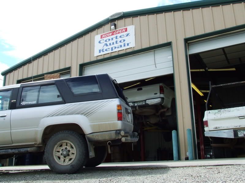

My starter began to act up on my recent Colorado trip even though I had the contacts replaced just a year ago (I feel it's a Mr. Sucky issue!).
Symptom~ Drive truck......turn truck off......try to start it while hot after 5-10 min. .....won't start. Let it cool down for about an hour....starts right up.
The shop in Cortez that was going to do the work was able to get me a new/rebuilt Toyota Factory starter for $175 from the Toyota dealer in Durango, CO.
I decided to put a whole new starter in because I was not sure what I had for a starter now.
The shop had to actually unbolt my engine mount at the starter side and lift the engine up a little, to get the starter out because of my new Downey Headers (a job I could not do on the trail!)
So I decided to go with a new starter for the same labor amount as to only rebuild it.
Working fine now.......
I will rebuild my old starter and keep for a spare.
If anyone is ever in need of help around the Four Corners area.......
Check out Cortez Auto Repair......in Cortez, Colorado.
Very fair and honest!
See Rick at the Desk and owners Fred and Todd who do the work.
You can stay right next door at the Aneth Inn while they do the work for only $35 bucks a night! Then use the motel as a comfy basecamp!
