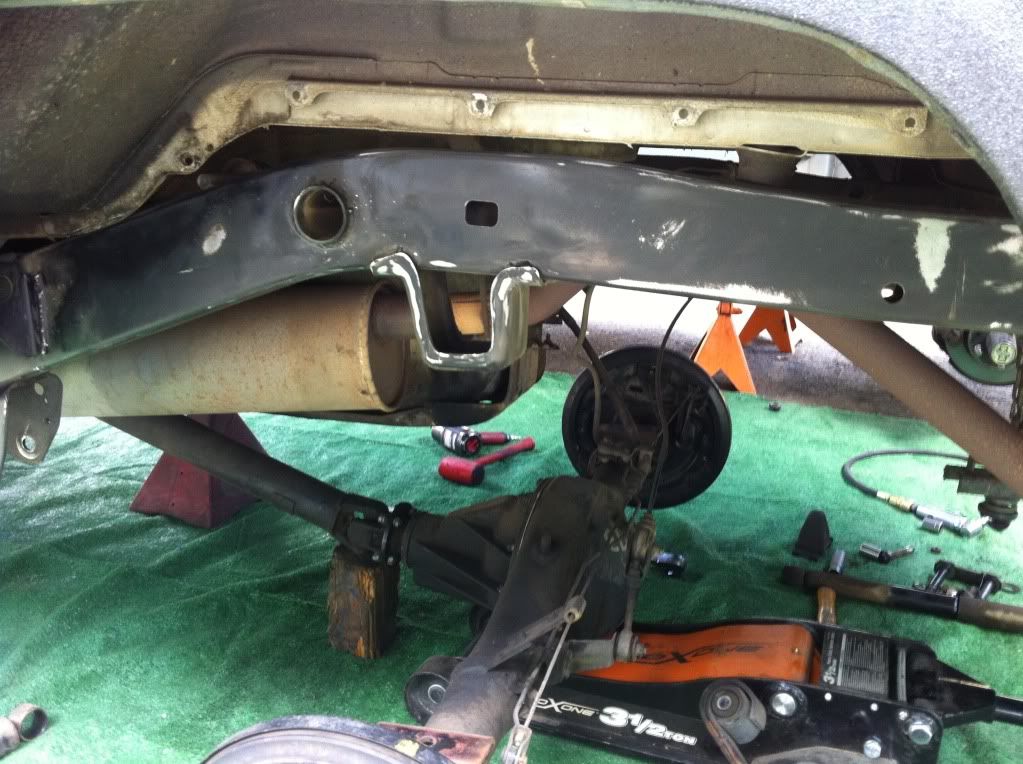

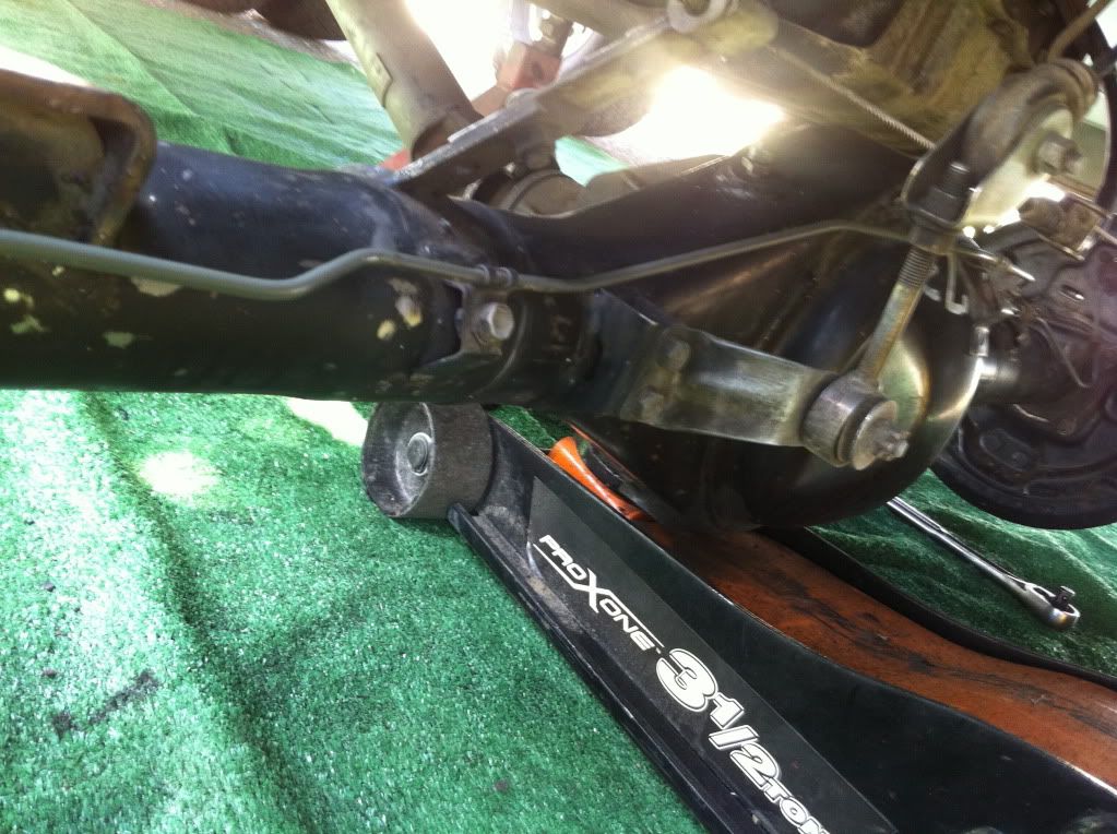

First I tore down the rear to clean and paint everything up:

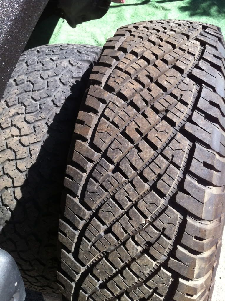

Got some new tires 33 10.5 R15 General Grabber AT's. These are the race version that I socred for $50.00 each off of a class 10 buggy team! They were used for about 100 miles in a race at Parker AZ, but most of it was sand. They are basically new with NO plugs!!

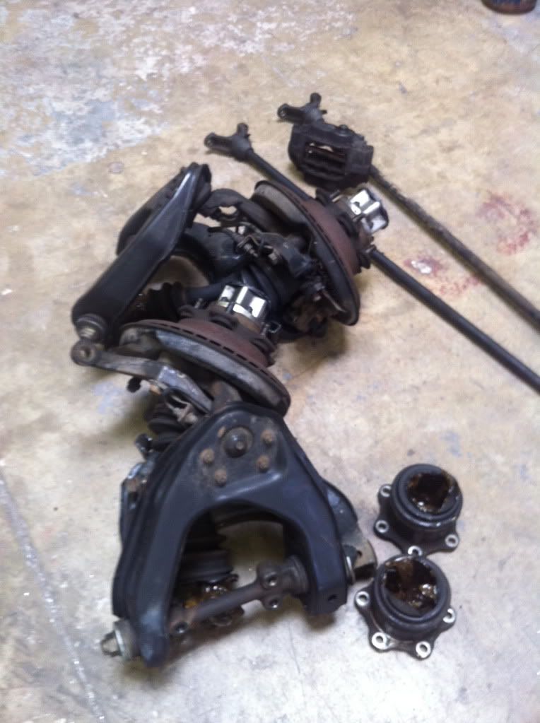

Out with the old;

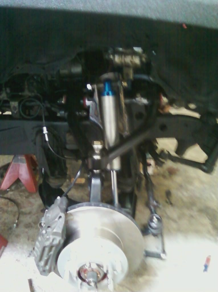

In with the NEW!!

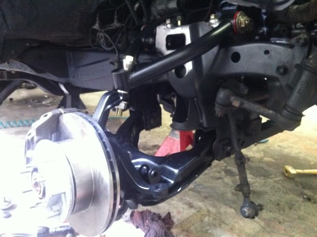

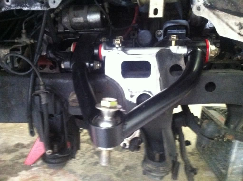

Upper arm:

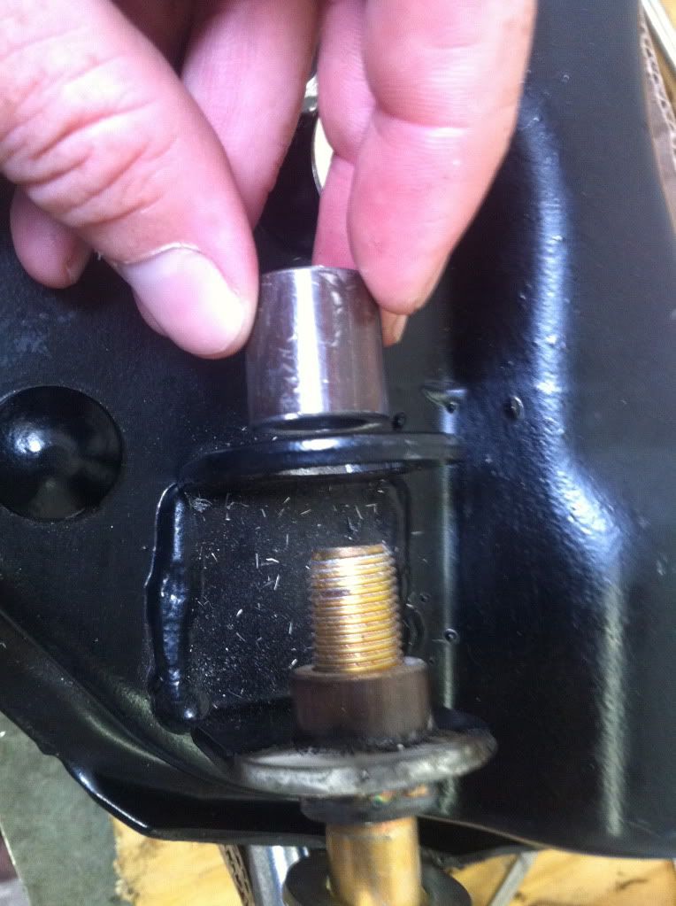

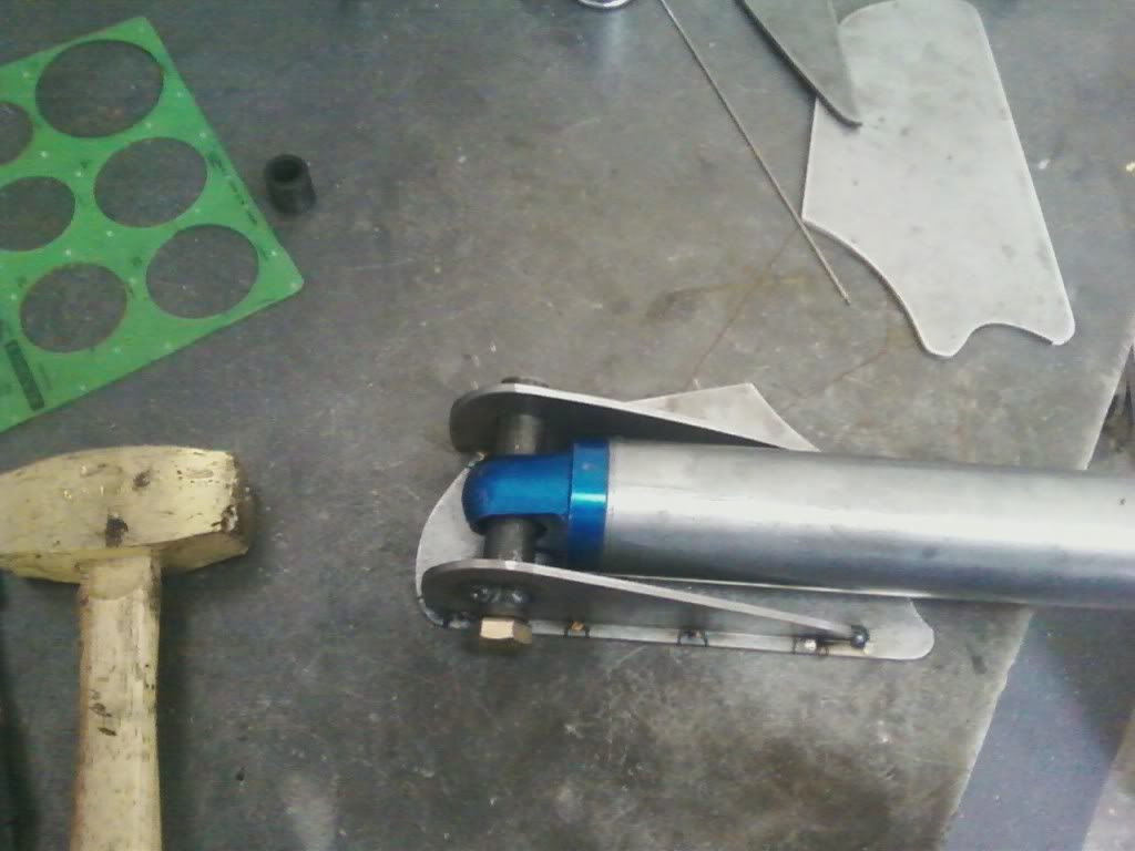

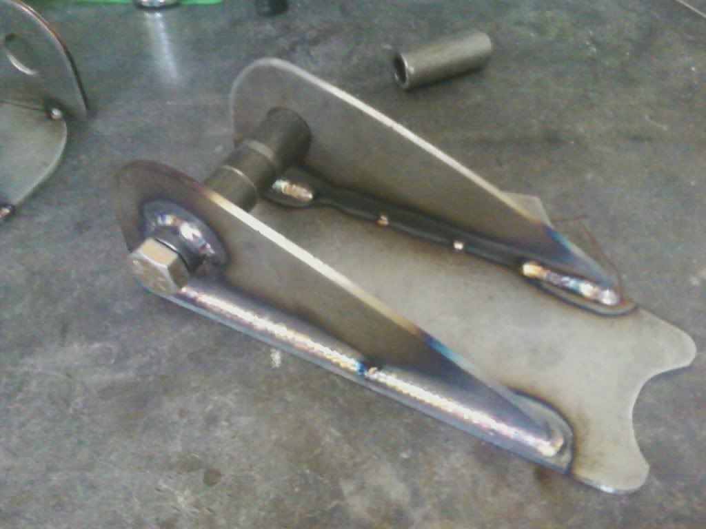

modified lower shock tab. It will now accept a 2.0 OR 2.5 shock and makes aligning the shock a breeze!
New lower uniball conversion:
All set to cycle:

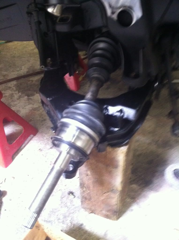

New Empi front axles;

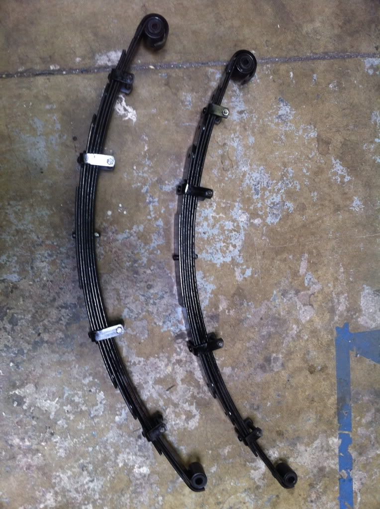

Custom Deaver spring pack, 1.5 inch lift, with 200 LBS of over load for when I am loaded down;
New upper shock mounts that will also accept a 2.5 inch shock;
Front all mounted up (sorry for the bad cell phone pic:
ALL of the custom fabrication is 4130 cromolly, and tig welded. :Wow1:

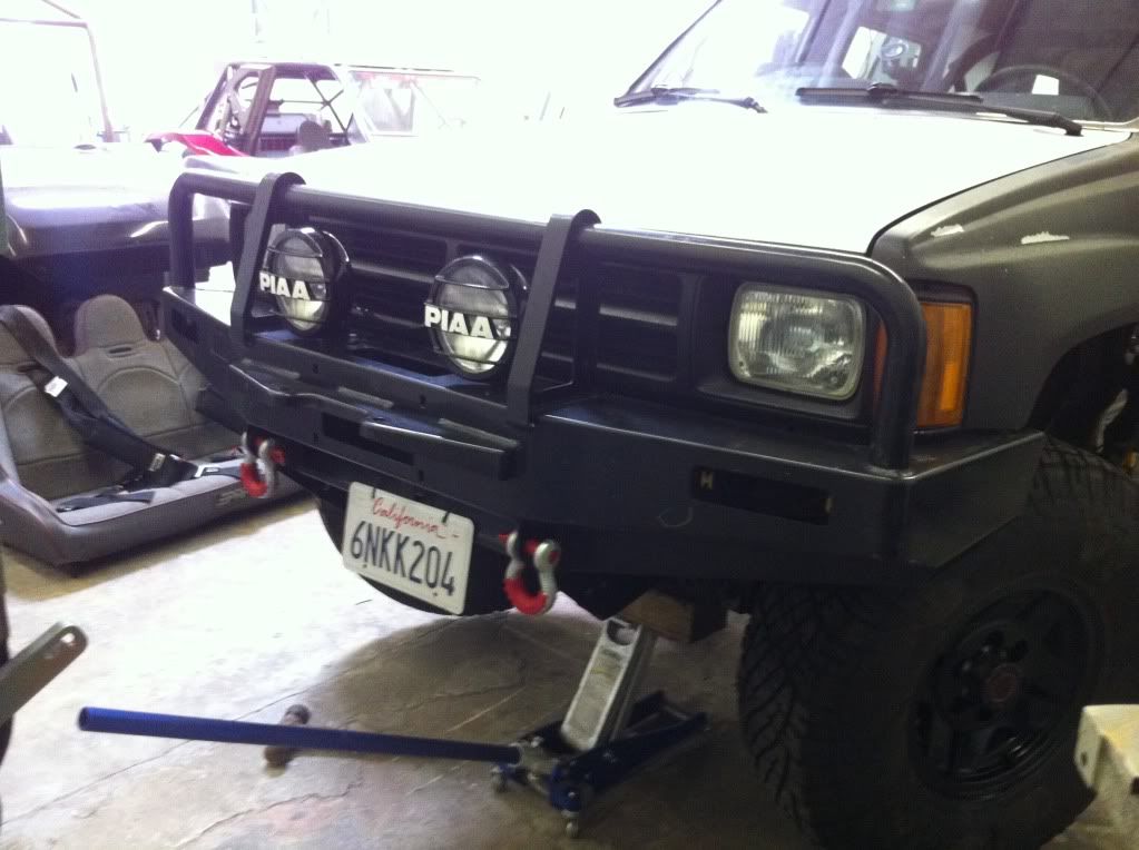

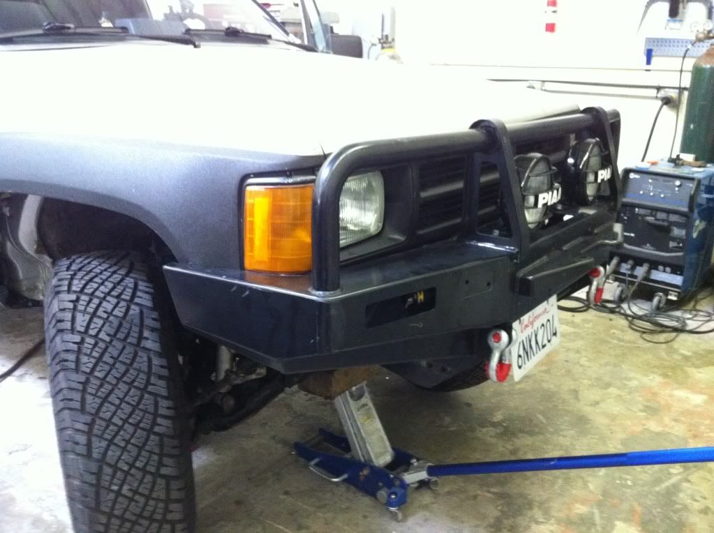

New front ARB bummer that I scored on CL for $350.00 WITH the Lights!

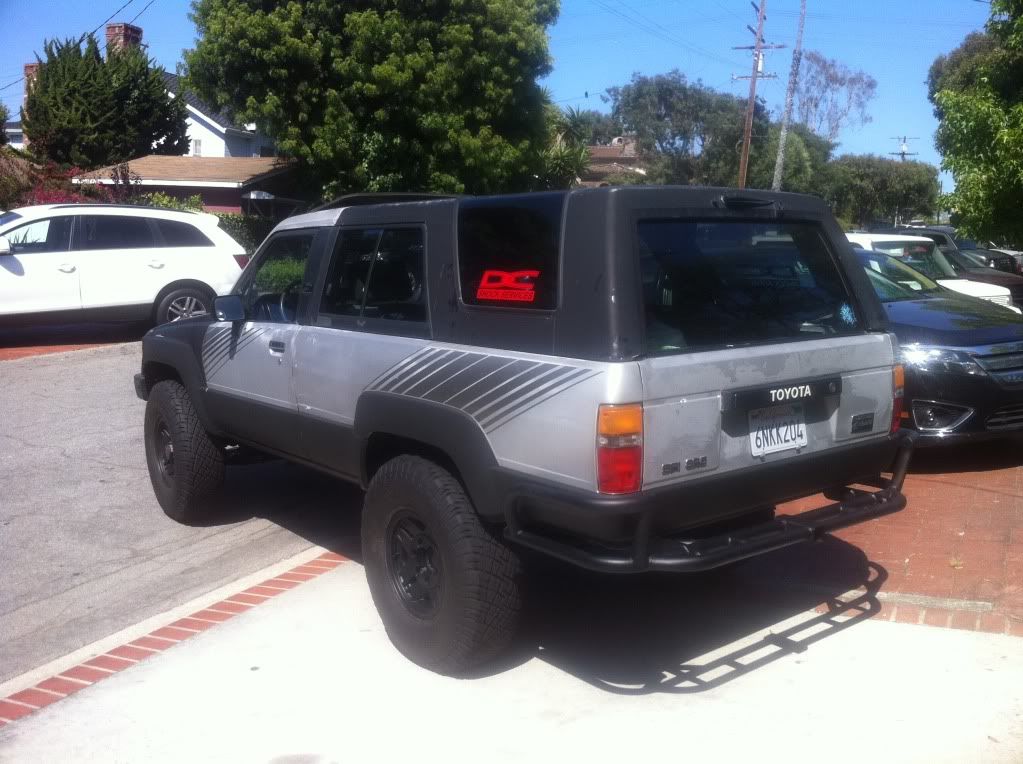

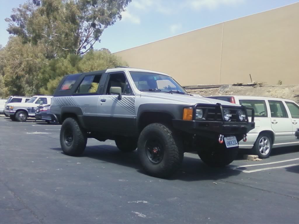

Here is how it looks after the suspension install:
I think it sits perfect hight. NO BODY LIFT, and clears the 33x10.5xR15's perfect with absolutely no rubbing at all.
