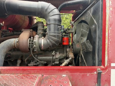

The DRD stands for "deep reduction drive", the more common variant is the 750DRD from the oil and mining industry. The weak point of the P-19 driveline is the power divider that sits between the engine and transmission. Before the box swap, I will remove it, or make it essentially a spacer.

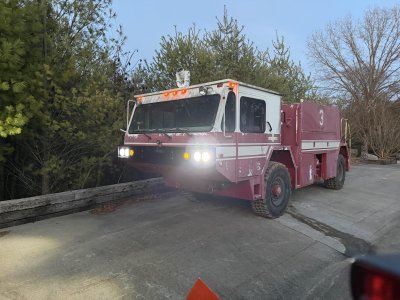

Headlights! LED lights and new headlight buckets installed, the front end must have gotten warm from a fire, the wires behind the bumper were all melted and crispy. They have all been replaced now and the lights work!
