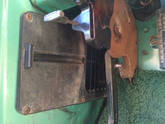

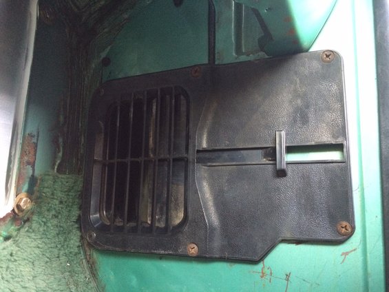

i'm pretty stoked on this little piece. there was an OE kick panel vent made for these trucks on the driver's side:
but not passenger side. There was a hole in the kick on the passenger, which is where the AC box drew its air from (and a great place for rats to nest, leaves to fall and rust out the cab etc). I picked up a second unit (my truck had none originally, just block off plates) enlarged the hole a tad and got the unit to fit on the right side. One of my favorite things about old iron...flip the vent windows towards you and open up the nut chillers...who needs AC!
Once upon a time in a land far far away I was riding in a friends El camino that had those. I froze my butt off for two hours before I figured out that I could just close the vent by my feet!
HAHAHA
I had an old Plymouth Duster in high school, I once hit a buck fifteen on the freeway and one blew open and threw leaves all around the cabin! I stopped driving that car fast after that, scared the crap outta me!

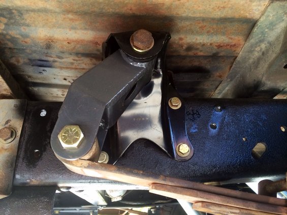

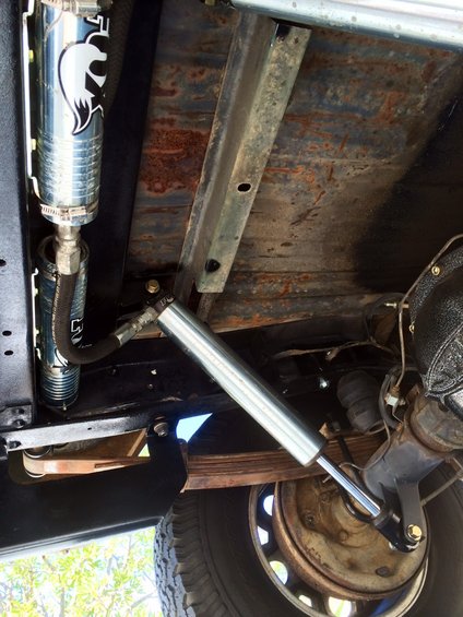

more progress on the cheap truck...got a little longer set of shocks for the rear, some new shackles and hangers, and cleaned up a bunch of rust and grime that had accumulated back there over the years.
gained about 1" of wheel travel by flipping the shackle and running a longer fully boxed race shackle. The hangers are a Dorman replacement hanger for an 80s F150, the shackles are a universal/older F150 Synergy Race shackle (soon to be disco'd, get them while they're hot!). The longer shocks let me drop the mount down off the axle for a ~15* degree improvement in shock angle and I was also able to move the rod about 1.5" closer to the wheel. All these little things add up to big improvements in shock performance too....ideal shock placement is always straight up and down at the wheel...anything else is just balancing the compromises of "how much crap do you want to cut out of the way and how much intrusion do you want into the vehicle". Ride height, to me, looks largely unchanged...Maybe 1-1.5" taller in the back.

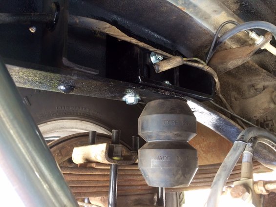

I personally don't like the complexity of air bags, and adding in over loads to the spring pack doesn't always have the best riding benefits, so I settled on trying out some of the famous TIMBREN AEON rubber springs. from what I gather, it is basically a bumpstop from a dump truck, but they are rated to add 3000 lbs of capacity. From my preliminary speed bump test last night, they are very stiff and should fit the bill perfectly. I'm going to swap some shorter, softer bumps in for most of the time, but nice to know that these can be swapped out in 2 beers time with a floor jack and socket wrench. All my fasteners are either 1/2", 7/16" or 5/8" in back now too, so 3 wrench/socket combos covers EVERY single important bolt behind the cab.

Have you noticed any more axle wrap with the shackle flip? I get a little when starting in 2nd (which I do 90% of the time) but only if I give it too much go pedal right away. Looks good as always! Your motto should be "Mod smarter not harder"!
I haven't noticed much more axle wrap yet, the datum line on the leaf spring (big factor in anti squat behavior) only moved about 1.5" down. It probably will hop a little more, but hopefully I can tune that out with the shocks. I didn't do it for lift, mainly to smooth out the spring rate. In the normal position the shackle creates a falling rate, now it creates a rising rate; my biggest complaint was that the rear used to slam hard on bottom out...seems to be better now but thats only over speed bump tests.
I have to mod smarter, my wife gave me a tiny budget for this and I am really slow at doing stuff. If I made it complicated, it'd take forever!
