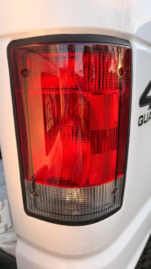

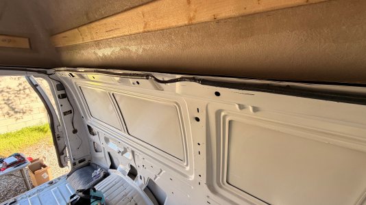

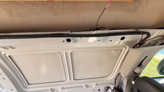

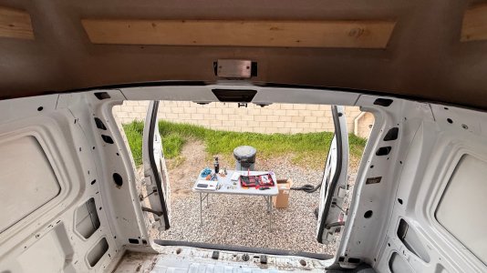

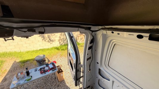

Decided to relocate the wiring harness that goes to the rear of the van to the inside of the walls so it wont interfere with future build-out. Didn't really take many pictures...

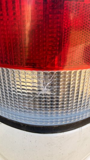

We disconnected the taillights, dome light, etc and then de-loomed the whole thing. We removed the rigid plastic protection and re-loomed the harness with fabric wire loom tape. A fiberglass fishstick, some long needle nose, many poke-y tools, and some choice words and the wires are now all hidden in the wall. Also replaced the taillights- one was cracked and I had bought new ones a few years ago and promptly forgot about them. Put some extra bright LED reverse bulbs in there too.
Of note, the connector for the rear door dome light/3rd brake light needed to be extended about 8 inches so it didn't end up inside the wall. I cut it off and soldered in extensions so the connection is accessible.
Before
After
