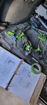

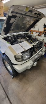

Been slowly chipping away at the wiring, went from tagged connectors to marked and verified connectors with individual wire ID. My friend Drew made me these labels with each wire number, color and duty printed. I got the Lexus side done last night as well.
One challenge we faced was the cruise computer location, there really isn't a lot of room to work up in there and there is not a male version of that connector (26 way AMP/TE Multilock Hybrid 040/070) to make a pigtail. I think what we're going to do is salvage the socket on the computer itself and bus the pins from the inputs we need (cruise switches) into the now unused output wires so that we can retrieve them elsewhere and feed them to the Lexus PCM. I thought that was super clever, glad I have someone helping me because I would have definitely done this the absolute hardest way possible or removed the dash.
