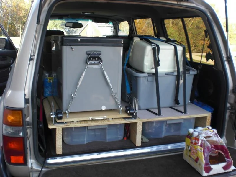

Here's how I would do the slide. It's basically how the Engel fridge slide is designed. If you need help working out how to size stuff based on your load requirements, let me know.
