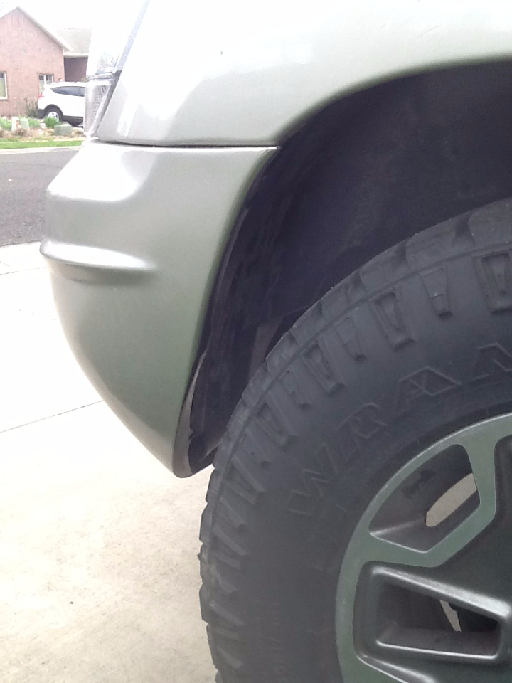

Finally finished my inner wheel plastic. My old ones had holes rubbed in the front from the wheel touching, so I got some replacements.
On my front bumper, I took the pieces and bondoed it back inside so I would have a trim piece to mount the liner to. I also used a cutting wheel and trimmed the back pinch seam down to the spot weld, then hammered the pinch seam over in the thinner areas. In the front wheel well, I trimmed off some of upper metal as well, to the bolt stud. Relocated my horns and the washer bottle. It may not look much different (but that was the goal, to gain clearance while retaining the stock wheel plastic liners)... so all the high metal points that the tire would normally touch while flexing have been removed. Three new holes have been drilled on each side for repositioning the plastic liner and it fits further up into the fender. Now she is all back together.
Final result was new wheel plastic and a larger opening for flexing my 31" tires

Now that the front fenders wells are all done, it was time to test the articulation. I crossed my fingers that my trimming efforts were precise, so I disconnected the front sway bar and flexed it out. The end result made me smile, no touching while flexing and turning.
My wife kinda l laughed when I tried to explain everything I did to get a 31" tire with only an upcountry lift to flex into the wheel well. When she looked in the wheel well... she said everything looked normal (like it was stock). Yet I have trimmed about 2inches in the front and and inch in the back. Cut bumpers, reattached the bumper lip with bondo, relocated washer bottle, moved the horns, upgraded to thinner fog lights, trimmed metal, hammered pinch seams and repainted the whole front bumper.
I don't see too many WJ's that can flex a 31" and still have a wheel well that's looking clean... let alone has a inner wheel well plastic still intact.
