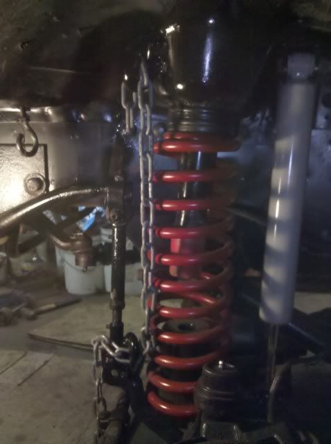

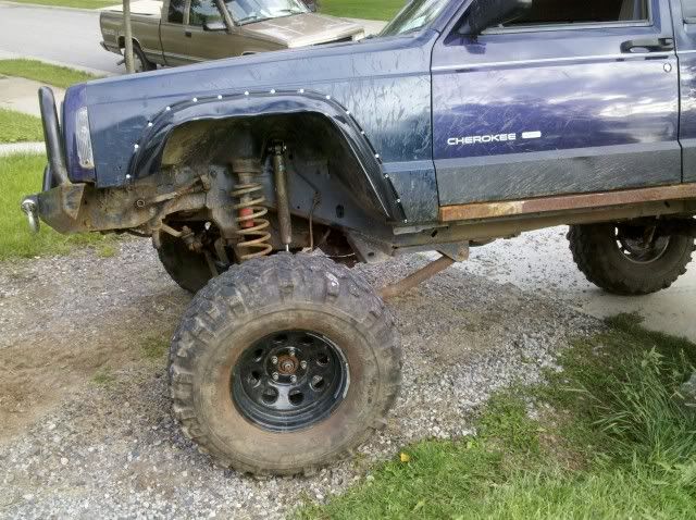

Having long arms, you get a lot of suspension droop. Enough where a 48" Hi-Lift would run out of room.
To counter that when using the Hi-Lift, I welded hooks on the sway bar brackets, and the spring towers.
Using a short chunk of chain, it kept the suspension from drooping.
Much easier and safer than using a strap. I've had straps slip and break, after that I came up with the hook idea.
