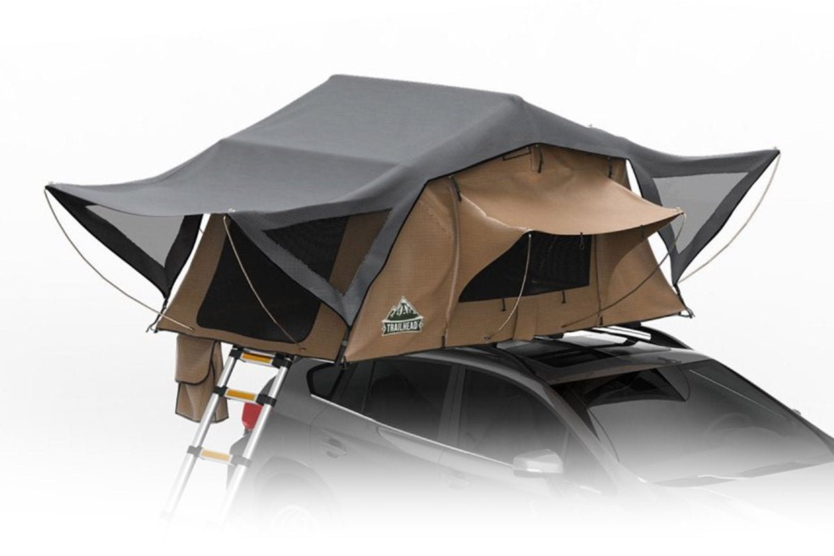

I was looking at their soft-sided RTTs. Does anyone have any experience with TSO's Trailhead:

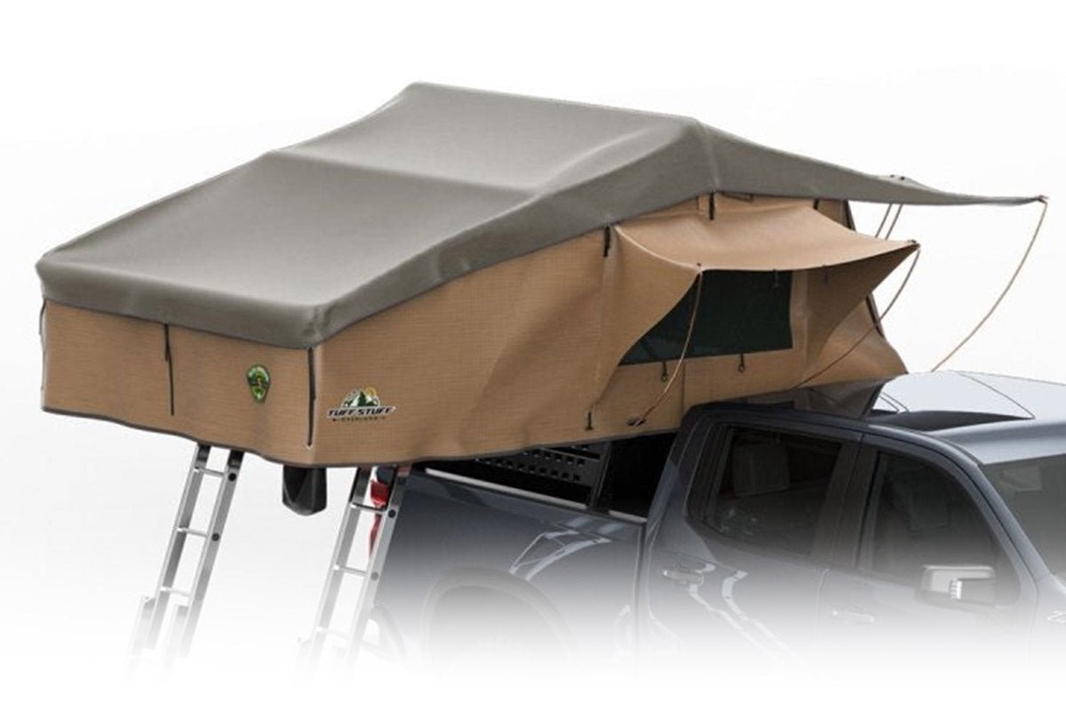

TSO's Delta:
TSO's Ranger:
