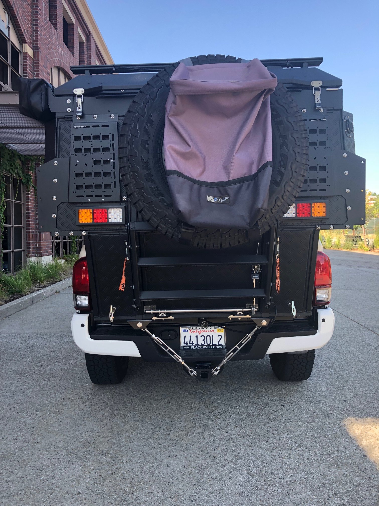

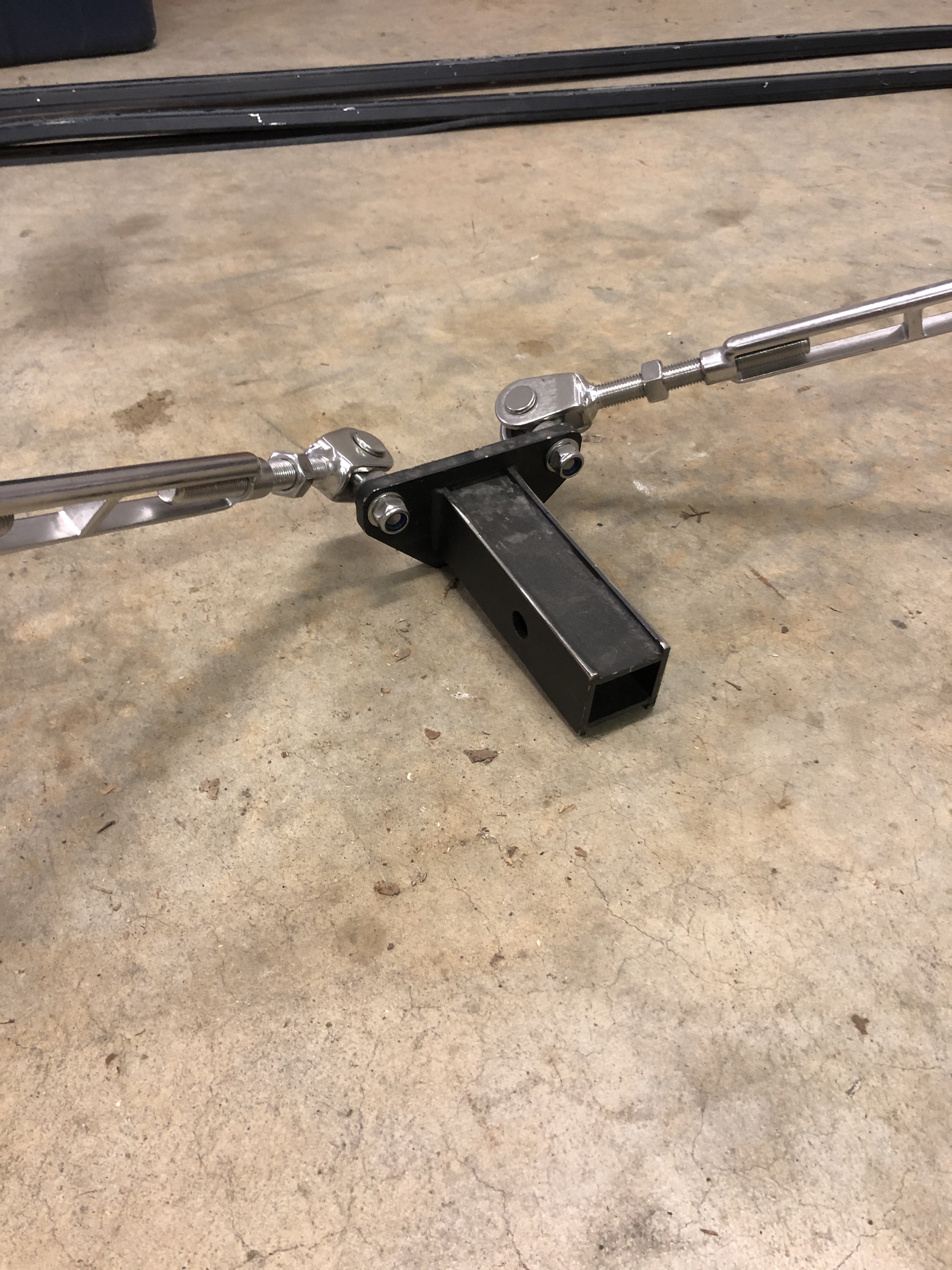

I was the Alu-Cab dealer in NorCal for a few years and had several Khaya's on my demo rig. I always hated the 3rd point rear mount and was never satisfied w/ the appearance or strength of the parts supplied, so configured my own mount.

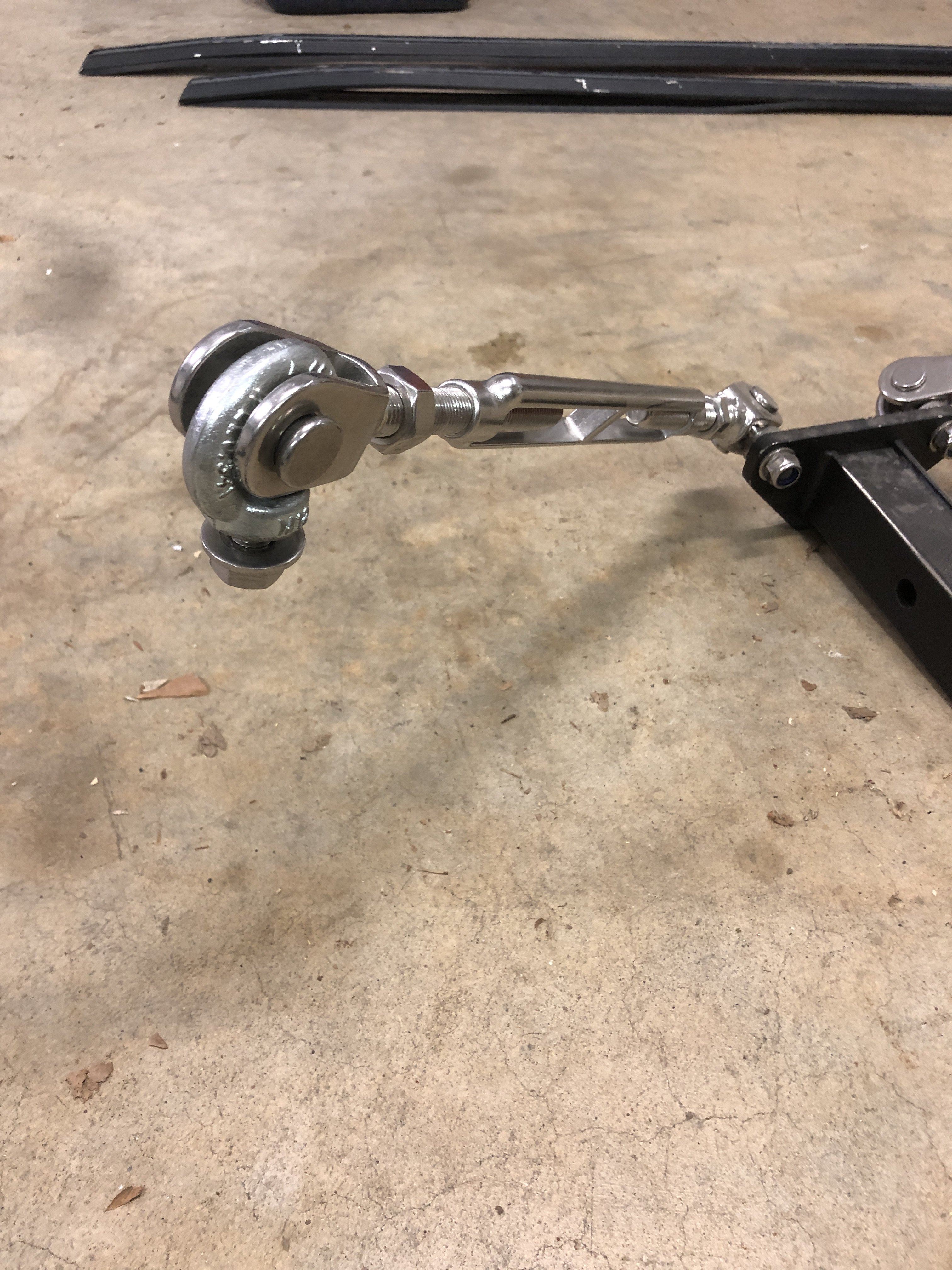

The 2" receiver bit is aluminum and the turn-buckles are 5/8'x8' stainless steel from e-rigging.com and rated for 2,200lbs per unit. Specs are here:
The turnbuckles are $95 each plus the cost of the receiver and related hardware...so well over $250. I no longer have a Khaya and have no use for the parts, so just want someone to have this killer set-up. Everything is here for a direct bolt-in application.
$100 plus shipping on your dime

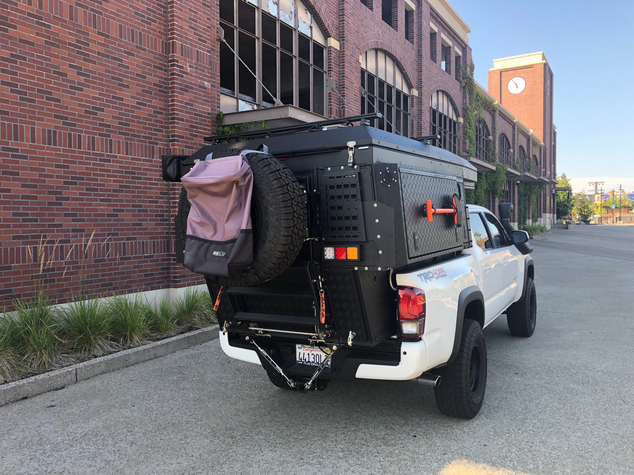

I redesigned my rear mount also. The rig the dealer set up had the turnbuckles pulling the camper out of the bed. They were bolted to a pintle hook receiver hitch plate that would run aground occasionally. The Ranger bumper has a fair amount of steel in the step below the license plate perhaps vestigial from the days of mounting a tow ball there. I drilled it out and mounted some eyebolts and reused the turnbuckles. I can use the hitch now and probably lost 50 pounds.
