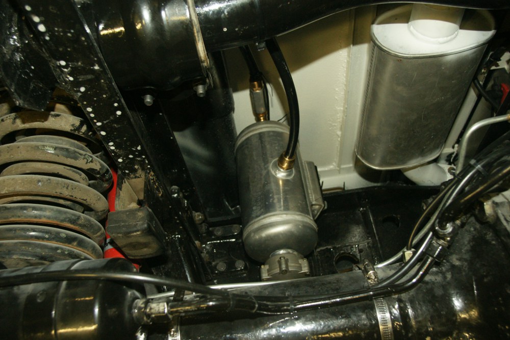

Hi Ian, a question about the exhaust system of your truck. Can you describe /and or show some pictures how it is routed all the way back?
Is it located inside the chassis rails ? Where did you find the space to install a muffler?
Here are a few photos, the exhaust pipe is 3" and now I have no muffler, and there is not much difference in sound inside the truck at all. The muffler was right at the rear.
I have changed the route quite a bit, mainly because since I have certified the truck for passengers in the rear, the exhaust has to exit at the very rear of the truck. I also wanted the exhaust high up inside the body to keep it clear of any dry grass.
Here are some photos from our blog.
This is the route of the dump pipe after the turbo. The first part of the exhaust is ceramc coated inside and out to limit the heat transfer to the cab. I have also wrapped it with ceramic tape as extra heat insulation.
The exhaust then goes close up to the camper floor.
The muffler used to be right at the rear, high up above the rear axle. Now I have all the air tanks there, but there is still enough room for the 3" pipe.
The left rear storage box is 4" smaller than the one on the right.
I direct the exhaust down, it keeps the soot from the rear door.
In relation to this, for the OM352/366 engines tuned to 200-250 HP, I wonder what is the optimum exhaust pipe diameter?
I would think 3" is a minimum, but would something be gained with a 4" ? Maby in your case space at the rear would
be to restricted for a 4" ?
How is the sound levels from the outside having no muffler?
A 3" is good for over 300hp, anything bigger is just for bragging rights. People are getting over 500hp from turbo cars with 3" exhausts so our 200hp should be easy. Noise wise, my wife says she can't hear much of a difference when I drive past.
