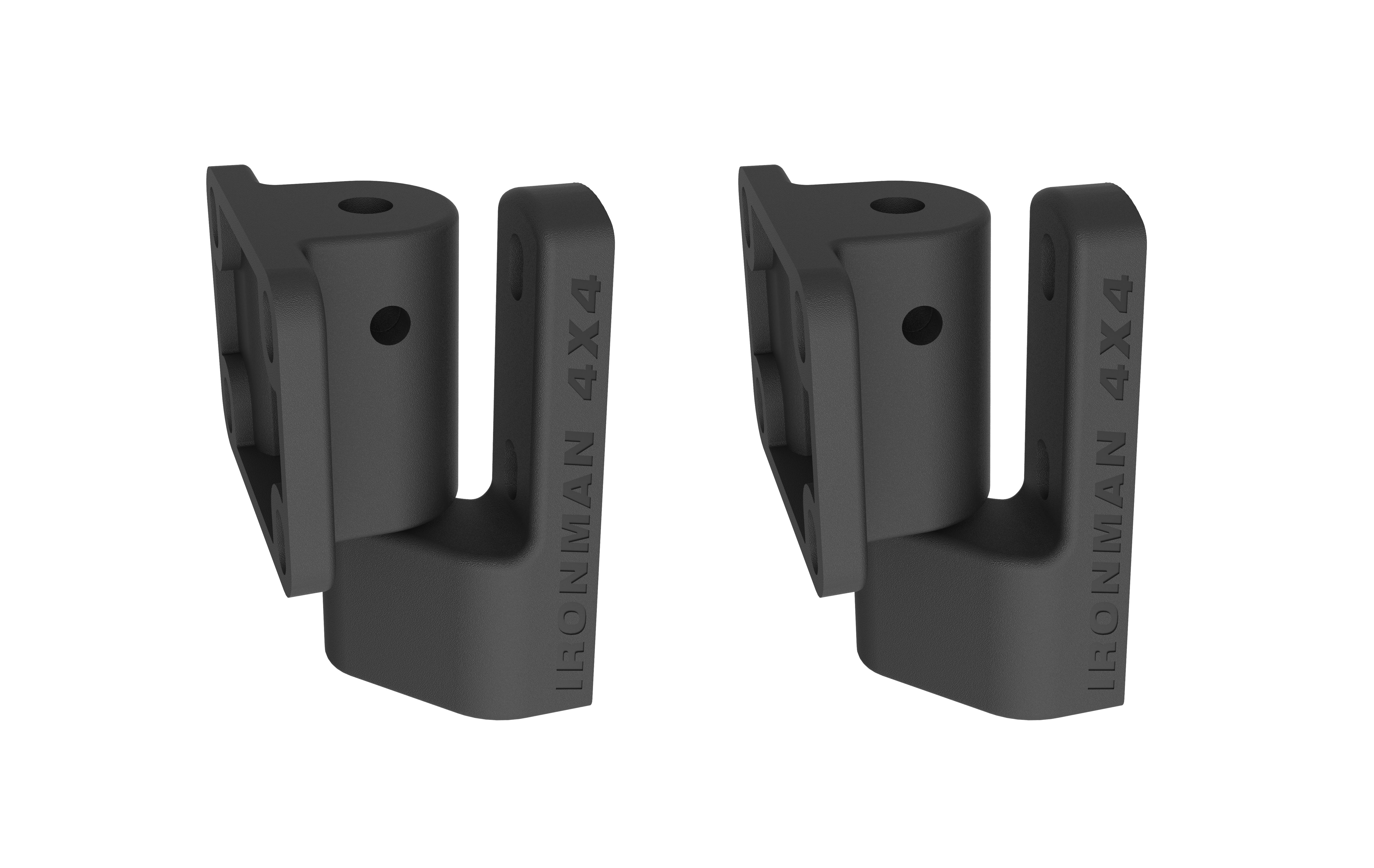

What kind of "quick disconnects" did you use there? I'd really like to take my awning off when not in use, but it's a real hassle with the setup that I have.
I believe these are the model:
Yes indeed they are. I like these ones because they work well with my side latches for opening or closing the top. I did not like that they are plastic but they've held up well and I only needed to buy half sets for the one side and in my shed for storage of the awning. A word of warning though, these do rattle so if that bothers you find a different solution!
Yes indeed they are. I like these ones because they work well with my side latches for opening or closing the top. I did not like that they are plastic but they've help up well and I only needed to buy half sets for the one side and in my shed for storage of the awning. A word of warning though, these do rattle so if that bothers you find a different solution!
I used hinges to ghetto-fab my quick disconnects. Bolted one side of the hinge to the bracket on the UM, the other side of the hinge to the awning mounting spine. Replaced the hinge pin with a long 1/4-20 bolt and a locknut. Can have it removed or installed in about 5 min or less.
I did a similar setup myself before I found the disconnects I'm running now. Instead of a bolt I used a hitch pin on both ends and made some "C" shaped brackets out of square tube. For the awning side I used flat and welded some bushing stock that was cut to length and drilled out to match the pins. It worked really well but I knew I couldn't mimic the exact spacing on the new awning mounts for the other side so I removed them. The ironman disconnects are tapered so there's a little room for imperfection.

I have an ARB 2000 awning on order to use with a J30 (also on order) and was hoping that the Ironman quick release brackets would work with the Ursa Minor brackets. Let me know what you find out. It looks like the Ironman brackets would attach using 4 bolts to the ARB and 2 bolts to the Ursa Minor brackets. Just a question whether the spacing of the bolts will match both the ARB and the UM bracket.
Thanks for all the input from everyone regarding the quick disconnects for the awnings.
I have an ARB awning and the brackets on my J30 are the ones supplied by UrsaMinor. I'll have to get out there and take some measurements to see if these disconnects are going to work for me. If so, I'll probably go the IronMan route, but otherwise I guess I'll be working out some ghetto-fab like m-l_johnny.
Again, thanks for the advice.
They bolt right up. The holes in the awning, brackets and mounts are all standardized to work. The Ursa Minor brackets actually have more holes than you'll need. As I recall Ironman doesn't provide you with all the hardware needed so you will need to source some metric bolts and nuts at the hardware store.
And I should also add that you should buy button head bolts for the Ursa minor awning mount to quick release bracket. Install them pointing away from the top to avoid tearing your bulb seal on the top like dummy me!
