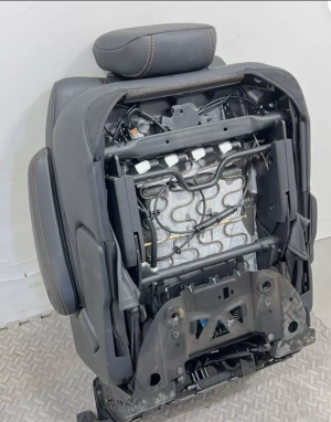

Gator 70, are those factory Isuzu seats? How thick is the base? Tell us more.

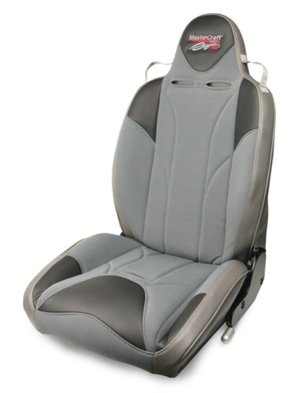

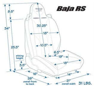

Mastercraft suspension seats have been used by the off-road community for years and even contracted to make their suspension seats for the US military. These may be an option. Initial price is more expensive than a used pair of seats out of a wrecking yard or off FB Marketplace, but they are new and can order them in any number of colors, so no added expense of reupholstering.
And nice they include the measurements.

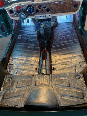

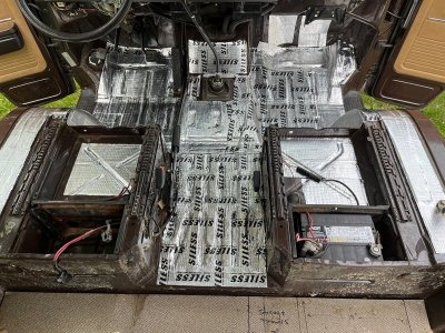

I have done the same process in most of my older vehicles (86 VW Syncro and 69 TR6 pictured) and the Fuso will get the same treatment, but the Fuso will get the added insulation layer as you did.

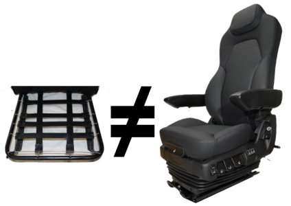

Given the restrictions of the Fuso, being the seat base size limitations and the lack of headroom, this is the most I can probably hope for with regard to "suspension". This is the design of the seat bases in my MG midget, no solid sheet metal pan like in other seat designs. I believe the Mastercraft seats use a similar suspension system.
You are correct MOG, suspension seats would be ideal if the FUSO had the headroom for a proper seat,
We seem to be 'understanding' differently. Air-rides seats (which I am singing the praise for) are 1000% different than the suspension seats that use straps that you have pictured.
You are correct, 'real' air-ride seats will not fit in a Fuso, unless you find a set of LKW/Unimog seats which still might be too tall. It is not only a headroom issue, but also a line-of-sight issue. That was one of the issues I had with the Mitsubishi Montero spring suspension seat bases, is I was looking about the windshield ( I am 6'4" so perhaps I could be the problem :unsure: ).
So 'bungie seats' are the best you can do given the Fuso cab limitations. Either build your own like you have before, or buy Mastercraft, Corbeau, PRP, Procar, and I know users of Scheel-Mann and they sing high praises of those.
Yes, air ride providing their "suspension" from an air bladder/bag and probably shock dampeners versus the webbing design that provides its "suspension" from the rubber bands. So, the latter is what I am leaning towards. Thanks for naming other brands, I will have to do some more searching. Those Scheel-Mann sure are nice, but for what they cost you really have to have deep pockets.

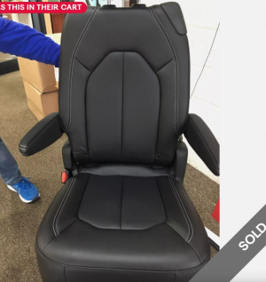

This seat is NEW from a mini van, second row seats. I watched ebay for a year. $250 each
Chrysler Pacifica second row seats. Have arm rests, metal frame, and leather. They fold down flat by design. Which was helpful for my application.
gator 70, Those seem like very specific seats, why were you set on these particular seats? Any pictures of them mounted in your Isuzu?
