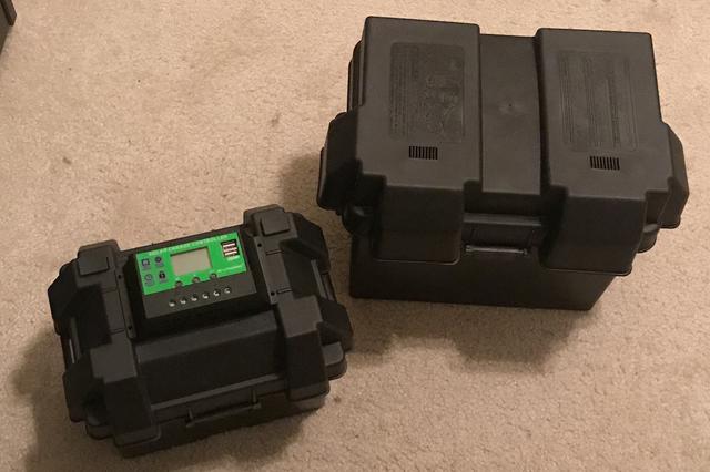

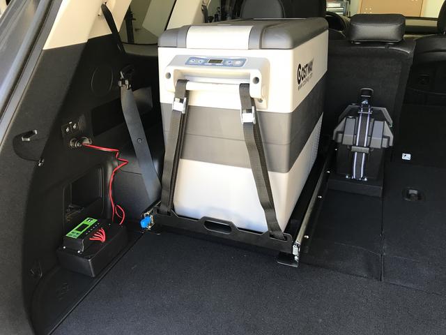

I built something similar to this for an upcoming road trip: https://roofnest.com/diy-portable-camping-battery/
Main objective is for the fridge to run overnight, and for the car to charge the battery while driving during the day.

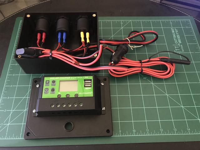

It's not much more than a battery box, battery, cheap solar charge controller, fuses, and receptacles. I think I'm in about $130. Battery is a Harbor Freight 35Ah deep-cycle U1 size, ran about $61 after coupon, and was the most expensive item. Everything else in the $8-$13 range per item/set.
Compared to a Group 24 box:
Went with remote box approach due to limitations mounting everything to the lid. The Group 24 box was too big for my needs.
The controller doesn't know/care if it's "car" DC or "solar" DC, so it worked fine.
A full battery (13.2v) run my fridge for about 16 hrs on high setting (5A compressor draw, when running) at 32° while at room temps, shutting down at the fridge's adjustable under-voltage setting (11.7v); fridge supports a lower under-voltage setting and an Eco mode so potential runtime a bit longer. When the car is running (13.7v) it powers the fridge and charges up the battery, without interrupted power when the car is shut off.
bjornb
What product/do you have a link to the smaller remote box? (the one where you mounted the solar controller).
