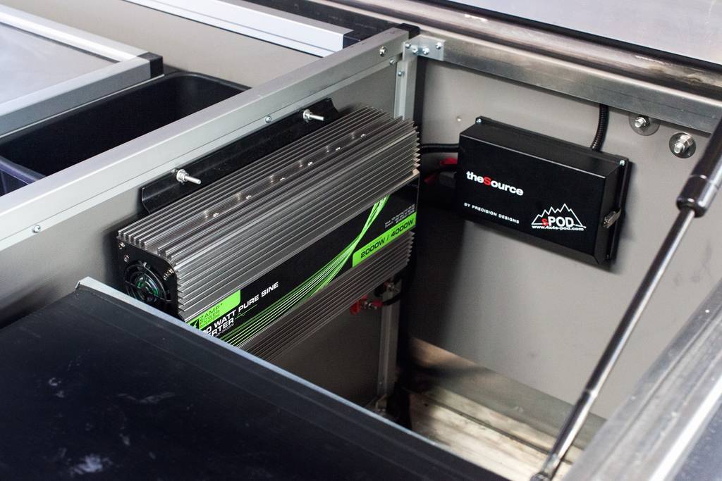

Close up of where the heart of the trailers gadgets are/will be going.
Currently have the ZampSolar 2000W inverter and the sPOD Source.
Above the axle on both sides are the Odyssey PC1800 batteries as well.
This area will soon house the Truma Combi4, SmarterCharger and whatever else tickles my fancy lol
