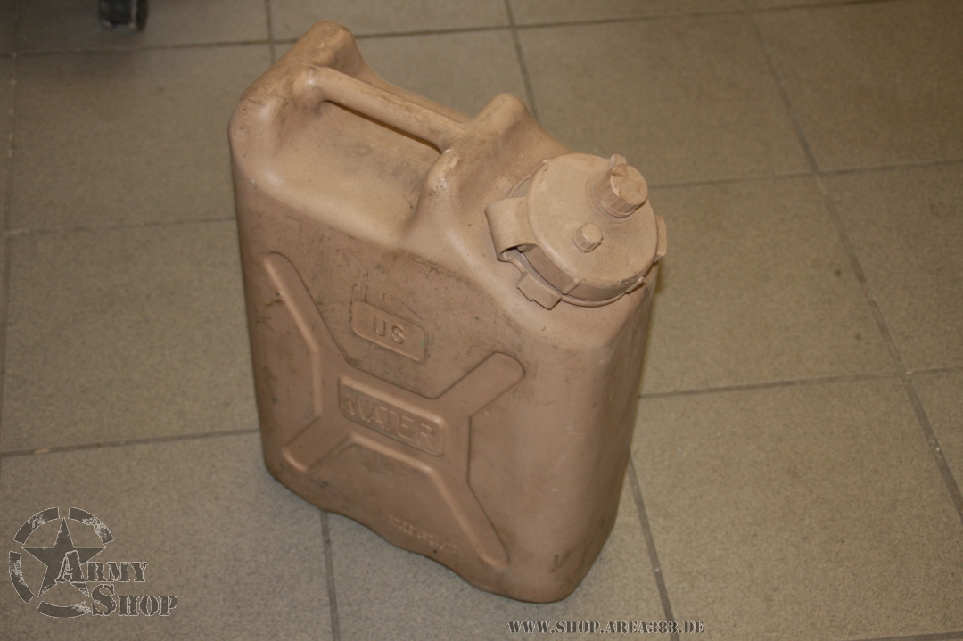

I'd suggest the 5 gallon scepter-like water cans from LCI. Here is thread with the link to buy them and instructions on how to tap the spout to add a hose.
http://www.expeditionportal.com/forum/showthread.php?t=41417&highlight=lci
LCI : https://www.redcheetah.com/lci/index.php
Do a guest login, search on "water can". Right now it looks like they only have tan and green.
