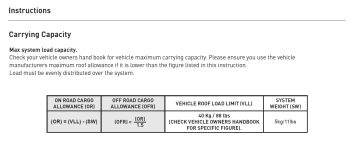

That info isn't hard to find using Google, this is from the Rhino Rack instructions:
From the JL Owner's manual:
Since the Rhino Rack weighs 11 lbs. and the manual states 100 lbs including the weight of the crossbars, it would appear that Rhino calculated the weight capacity by referring to the owners manual and subtracting the weight of their rack.
But also from the Rhino Rack web site:
IMPORTANT VEHICLE INFORMATION​
JEEP Wrangler JL 4dr SUV Hard Top 18 to 23
Not suitable for vehicles with "Sky One-Touch Power Top".
I don't know what was changed between the JL and JK roofs but I can't find anything solid that says the JK roof can hold ANY significant weight. The backbone systems offered that bolt to the sports bar, through the roof, look to be the only "roof rack" option other than @billiebob's suggestion above.
