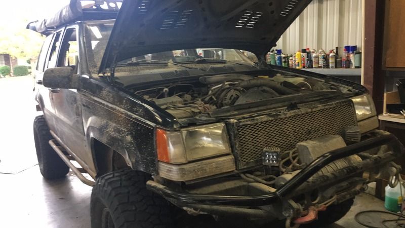

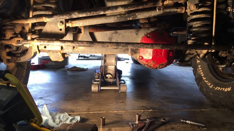

After breaking the front gears in December, I have now broke the RCV's and cracked the pitman arm. I've cleaned/ checked everything in the front. Had to replace hubs(1 bad) and install the u-joint axles and oem pitman while I wait for the warranty RCV's and a hd pitman. Also replaced the whining p/s pump, installed HID headlights, and replaced the failed CrawlerReady motor mounts for some Ironman mounts. Welded up the unibody by motor mount, roof, and two massive 8" gaps in the rear. And a bunch of little things everywhere. Oh and seat covers 👍🏻
I don't wheel it to hard, but I go 6-7 times a month easy. And really haven't had many problems in the 5yrs since Ive built it
