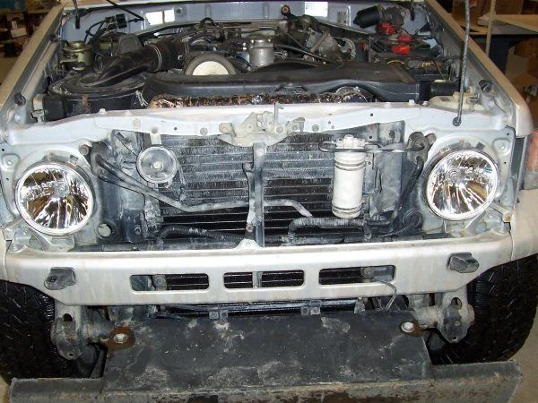

Decided to move to something cheaper and have been really happy. Haven't had any trouble in 3 years and they were about $30 each from the Freightliner dealer. (open 24 hours)
Trucklite TL27005
attachment.php
attachment.php
lowenbrau
I like that option. Might just have to give them a try on my 60. Are they an H4 bulb, or one of the 9000 series?
The Trucklites are H4 with a pretty good rubber cover. I don't bother with relays since my rig is 24Volts.
