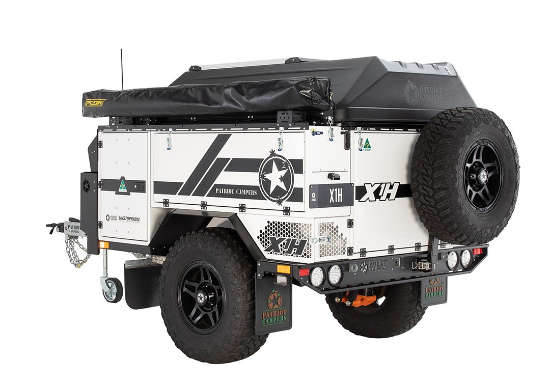

Picked up my new off-road trailer.
Towings beautifully behind the Porsche.
I have to make a slight modification to the external tire carrier to clear the hitch.

Excellent point about clearing the spare tire and giving room to open the tailgate.
What brand did you chose and will y'all have a RTT on top?
Are you able to fit Cayenne wheels on it to have common spare tires/wheels?
We looked at several models at the NWOR this weekend. Very good selection including Bruder, Conqueror, Patriot Campers, and many others. We were very impressed with the Patriot X1H. Still trying to grapple with whether or not we want to go the trailer route vs ground tent. Main concern is carrying that much weight climbing technical sections of trail. While we did not top having four Cayennes' at the event this year, we did have one join us on a trail run we led.
