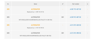

Hello Charles and thanks for the tips!
I did purchase/download an EPC program to my mac but haven’t gotten it to work.
Can you please share links to where similar programs can be used?
Also, I googled your contact and it looks like he is in Mexico. If that is correct, do you know if he ships internationally?
If anyone has a EPC, I would greatly appreciate a part number for
the alternator. The past owner has indicated it is original to the truck.
The VIN is: WDB6761981K030227
I’m crossing my fingers I can secure new casing for this one or more budget friendly option.
Thanks in advance!
Hello Charles and thanks for the tips! I did purchase/download an EPC program to my mac but haven’t gotten it to work. Can you please share links to where similar programs can be used? Also, I googled your contact and it looks like he is in Mexico. If that is correct, do you know if he ships internationally? If anyone has a EPC, I would greatly appreciate a part number for the alternator. The past owner has indicated it is original to the truck. The VIN is: WDB6761981K030227 I’m crossing my fingers I can secure new casing for this one or more budget friendly option. Thanks in advance! Sent from my iPhone using Tapatalk
What horrible luck. Hope you have a long stretch without issue once these things are resolved.
I believe this is the Merex he spoke of. They are in Germany: https://www.merex.de/
These knock-off EPC seem to come and go frequently. I have used this one before: https://webautocats.com/epc/mercedes/4/fg/676198/56s/
