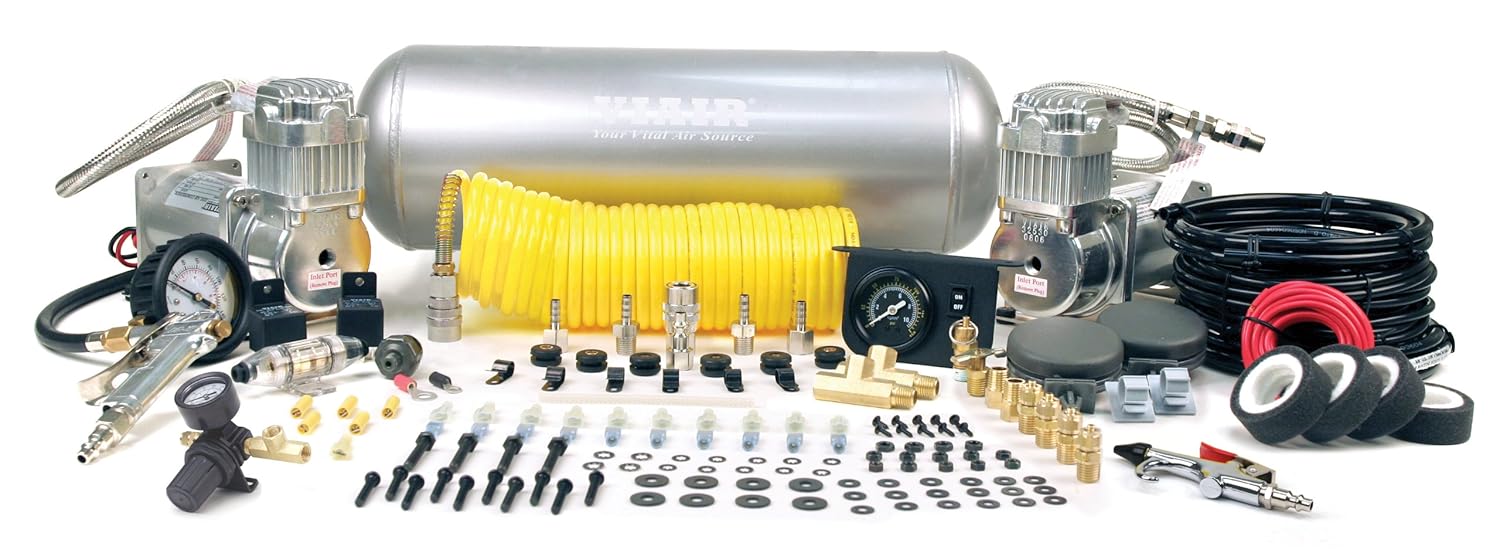

I can give a little bit of a review of the VIIAR system that I have been using since around 2010.
I purchased a kit that was similar to this:
Something like this but it was called a VIIAR 650 kit or something similar
http://www.amazon.ca/VIAIR-Xtreme-D...6099020&sr=8-18&keywords=viair+air+compressor
Install was easy, a few hours work and as you can see it does come with everything and then some, even spare filters. It does have an adjustable out going pressure valve with guage and another guage/on off switch to mount in the cab.
I have been using it constantly for five years and I air down for the slightest bit of dirt work and fill up constantly so it has seen allot of use.
I cant say it is overly fast but fills up my tires from 25psi to 65psi in 5-10 minutes or so for all 4, I cant say that it goes to 150psi as I never have had the need to go that high. It is much faster than most other people's compressors that I have seen. I having the two 100% duty cycle units working combined does the trick well. Was cost effective and has lasted now for 5 years, I have one kink in the air hose that is taped up and still works.
I looked into setting up my own york system and it would have been much more work and many of the items that come with this kit would also need to be purchased so I opted for the easier route and got going..... whats the rush filling tires up anyway? Its a good time to get out, stretch, have a look around.........chill.....
