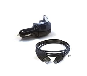

I've also got a doohickey like this:
Again, no replaceable fuse. Makes sense. It's rated for 1000ma at 5v. So it'd need a 1a fuse to protect the 5v output. Also need a .5a fuse to protect the 12v input. Also need a .05a fuse to protect the 120v input.
Good luck finding a fuse rated at 1/20th of an amp...
