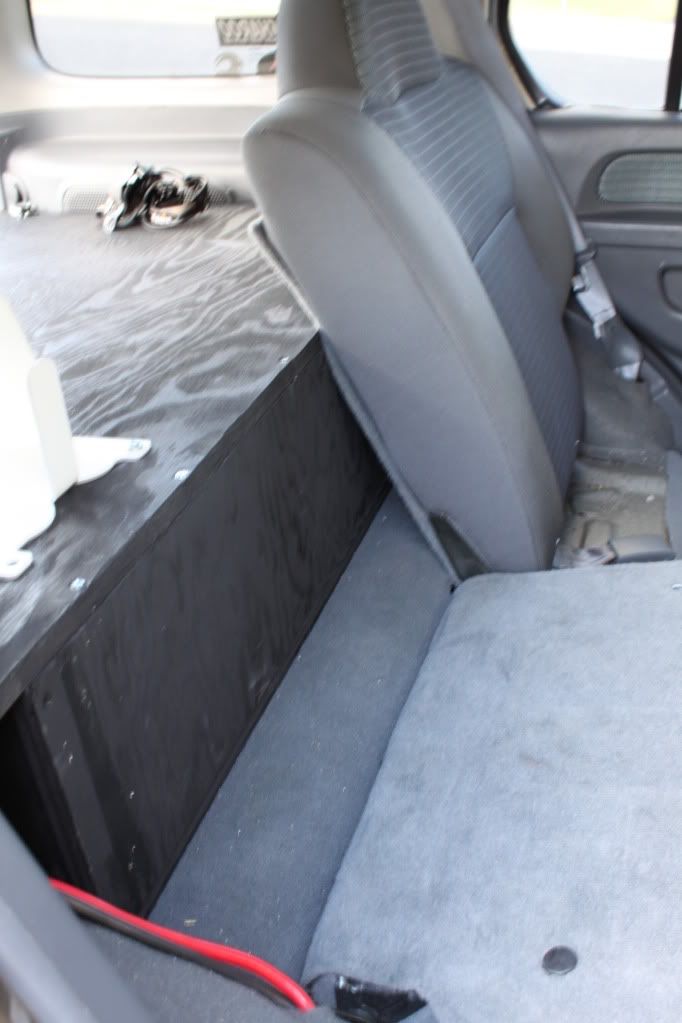

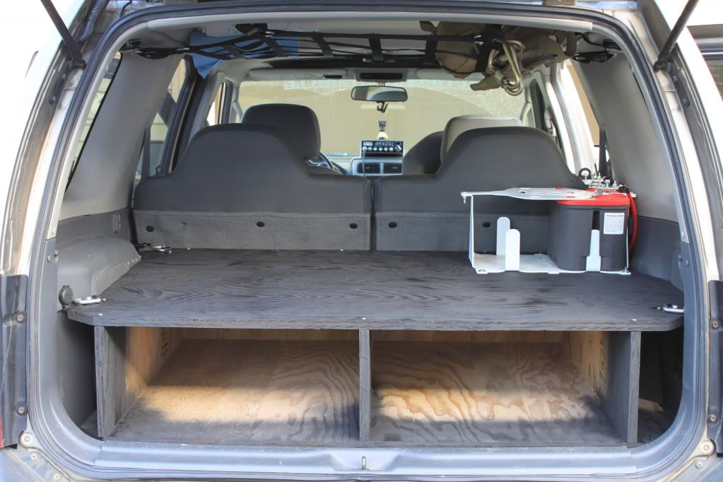

Heres My storage box that I made after doing some research, I haven't finished the draweres yet but they will soon come.. Let me know what you think

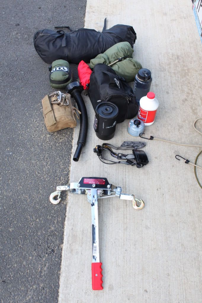

Some of the stuff I always carry
All that takes up about half of my right drawer

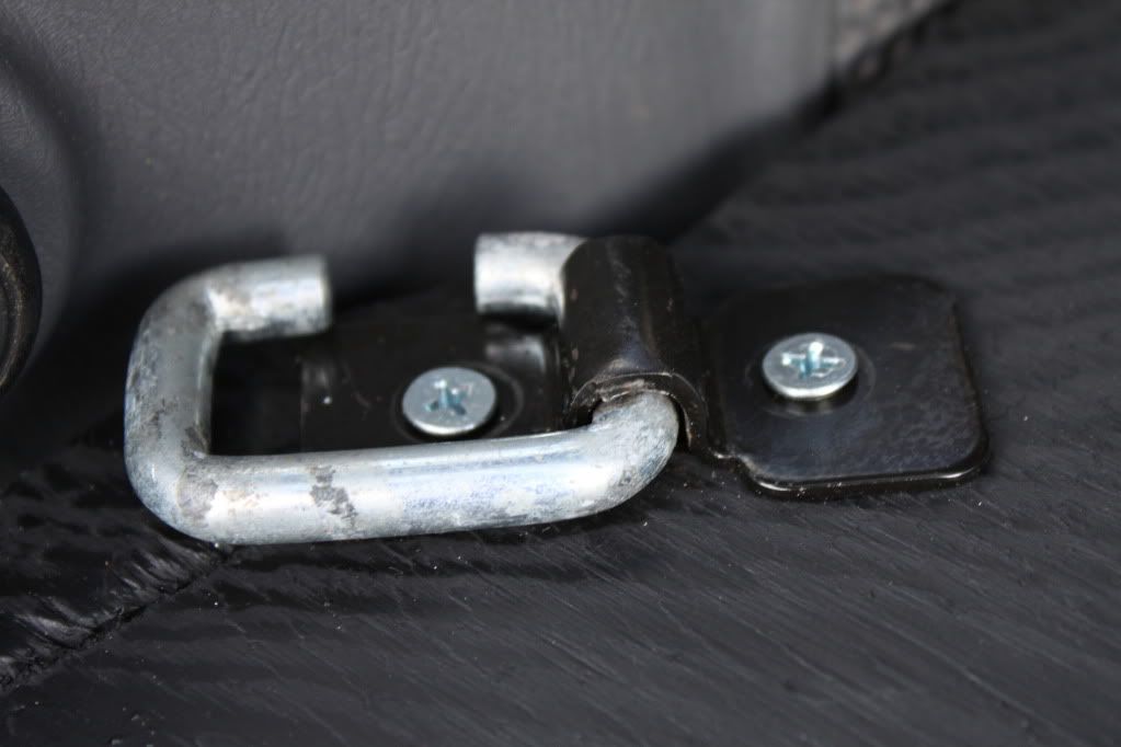

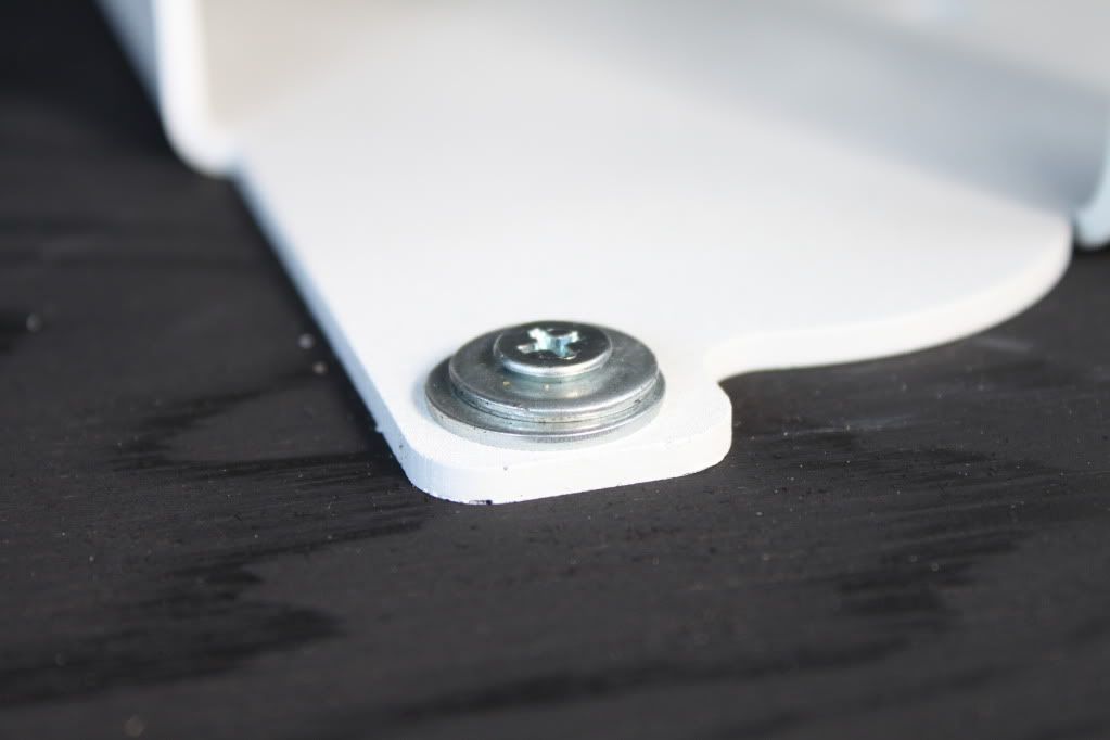

tie down points

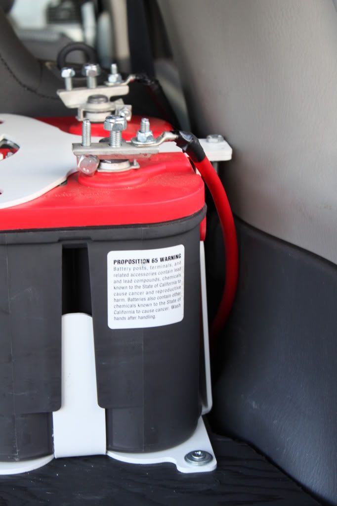

Dual Battery Mounts
Your set up looks good! I love the way you cut it to fit tightly to the sides, but something I would think about would be an enclosure for the batteries.. Besides the fact that they can emit gases.. (I dont know if the gases are poisonous, but its probably not a smell you want in your truck) But also for the fact that you definitely dont want something to go down on top of those terminals and shorting it out.
Gel and AGM batteries are okay in an enclosed area but any liquid battery has to be vented to the ouside. They can offgas hydrogen or leak posing a fire hazard. Covering the terminals is a good idea!
