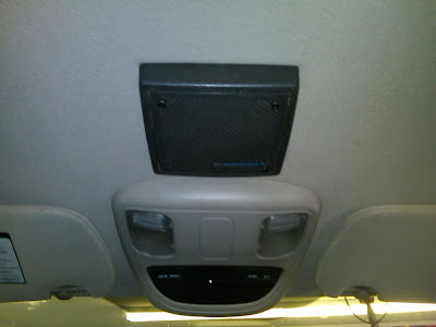

Just to add to your ideas, here's what I did in my Tacoma.
Started with this speaker:
Uniden Bearcat ESP5
Did some modifications:
Put it in my headliner... perfect location IMHO.
Write up is here:
http://www.ttora.com/forum/showpost.php?p=1965269&postcount=15
Thanks... my wife refers to it as my MacGyver speaker.:D
For anyone considering this, I'm continually impressed with the sound quality from this speaker/location. It almost seems as if the sound signal is wired directly to my brain through my right ear.

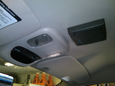

I believe in keeping the speaker close to the ear. Makes a huge difference in clarity when the cab road noise picks up. Here's what I did to my Matrix, and also Tacoma. Very simple, very hidden, very effective.

I did completely steal this idea though (thanks trump!) and got my Motorola mounted up.

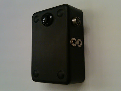

I've had this for a while but it fits in the thread. It's my PTT and headset box.
(old mount for it, I've since bulked it up and make it better but still in the same location.)
