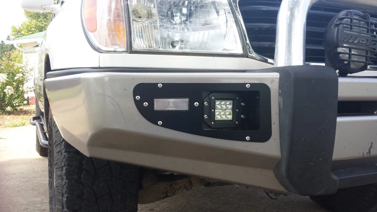

Yea but they sent the bracket ones, useless in my application. So I'm trying another seller. Picking up a set of these to go where the ARB logo is
And a set of these to replace the blinkers. Should act as a decent fog, ditch, camp lights They'll give me much wider front coverage at the intend angle. I have also seen a few people mount the lights on the bumper wings...
The turn signals the ARB comes with are also crap, and I want to get all the mounting holes cut before the bumper goes to powder coat
A little different that my install "LED Light bars in turn signal location on ARB Deluxe Bull Bar"
