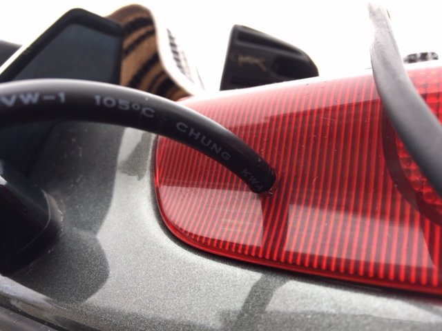

I decided that I liked where the rear lights were but wanted them wired into my reverse lights but had put off all the necessary wiring to make it permanent. Well, yesterday I got after it and installed the trigger from the brake light to the rear lights and decided to go ahead and do all the wiring for the final time.
I started out by running the wire through the upper third brake light lens, there is enough space between the actual light housing and the mounting flange to drop the wires right through. This does require a new hole, but I made piece with drilling holes in my vehicles a long time ago.
This is where I dropped the wiring through from the rear spoiler into the upper hatch.
img_0224-jpg.1382706
Then I used the lens as a template to drill a new hole directly below the lens. As usual I used some touch up paint followed by silicone sealant to seal up the new tight fitting o-ring. I've used this a lot on my cruisers and haven't had any rust nor leak issues yet... knock on wood.
