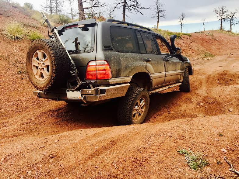

I got to get out and play for a few hours, nice to see the 305's tuck so nicely when I am twisted up and turning.
