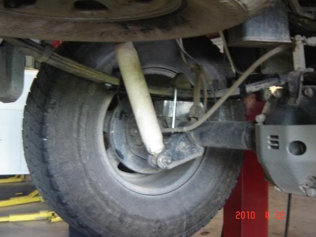

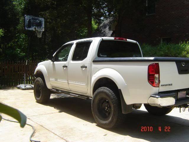

Replaced 4" blocks with 2" Blocks and 2-leaf pack
After 2 years of lift my rear leafs were really sagging. I ordered the 2" blocks and 2-leaf deaver spring pack from PRG products. The old u-bolts had to be cut off but other then that the install was a snap. Here's a view of the setup.
and here is one of the truck back on the ground
