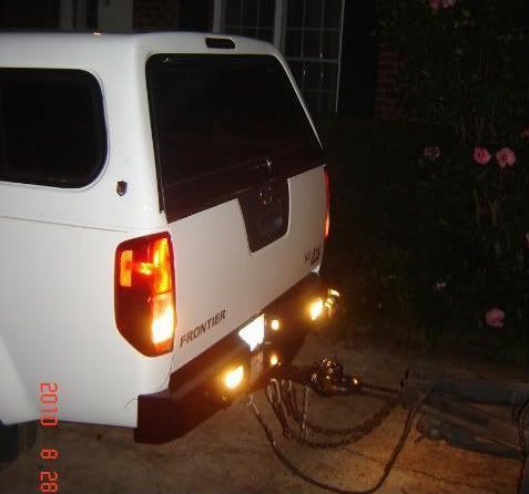

Shrockworks Rear Bumper with Backup Lights
After a long wait Shrockworks has finally produced a rear bumper for the 2nd Gen Frontier. It is a solid design real clean and easy to install. The unit has raised the location of my hitch by about 3" and provides a ton more clearance then the oem bumper and tow hitch combo while shaving a couple pounds off the total weight.
Best of all back-up lights. Anyone that's ever driven a frontier in reverse on a dark road/trail knows that the stock reverse lights are just not sufficient.
Added bonus now I can hitch my trailed in the dark.

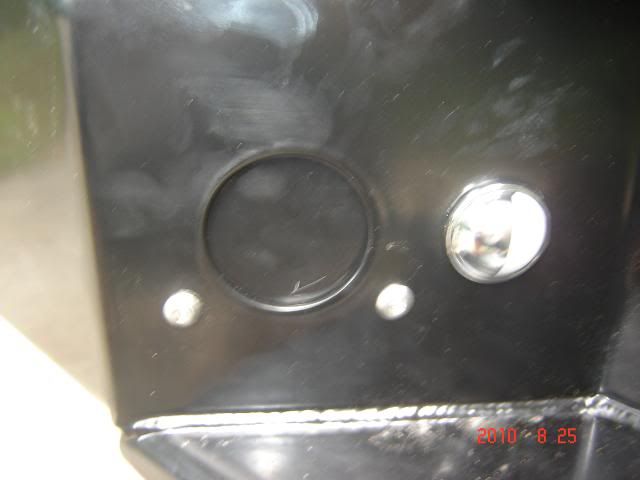

there is a predrilled hole for the 7-pin harness
but since I use the 4-pin I had to drill 2 holes
I mounted it on the underside of the bumper near the receiver and protected by the flange.

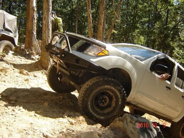

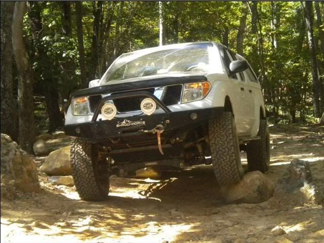

New Shoes
Well after much deliberation and research I decided to buy the BFG AT TA in size 295/75/16 to replace the Nitto's
Initial reaction is that they are quieter then the Nitto's on the road. The truck handles great! I can't wait to see what happens on the trails.
