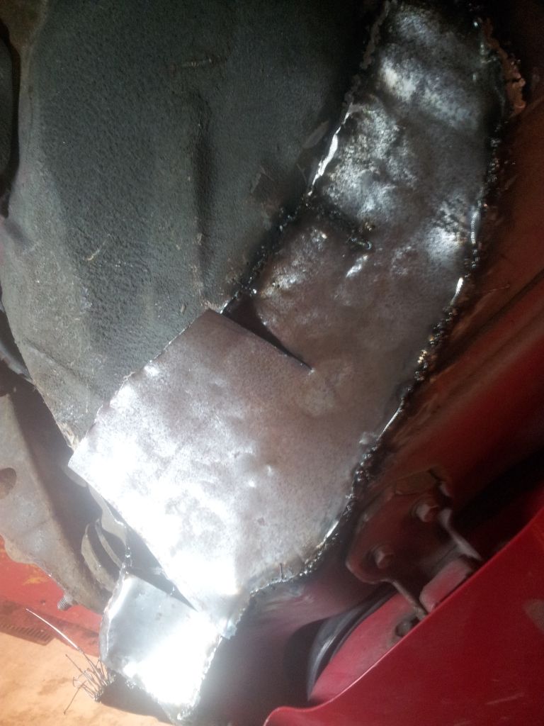

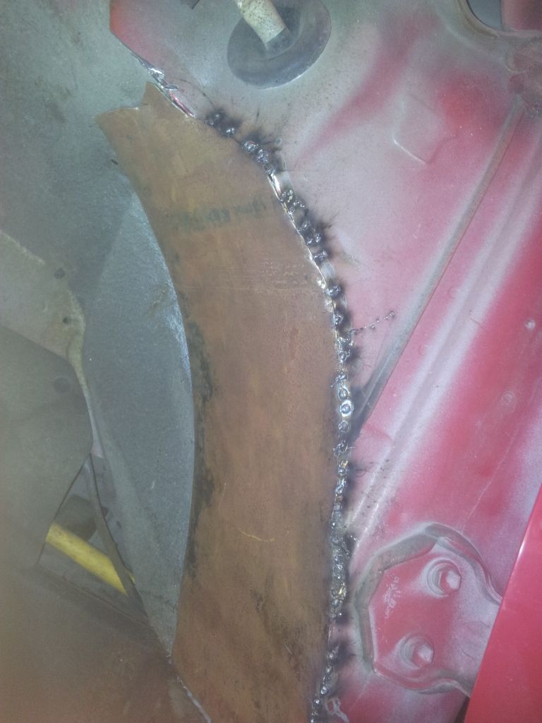

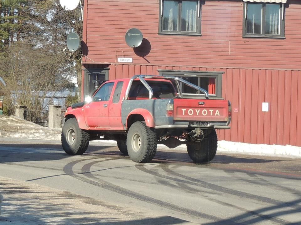

Came home and began to chop just a few hours later. Chop to 37s.
After 14 hours alone the RH was finished. Next night the LH was finished at 0530 with help from my brother. Did it at work (gas station) so got to do a little in the quiet hours while I watched the store. Getting payd and work on my car - so worth it :)
The result is awesome! Ground clearance by 15" and with 8 lbs of air they rock.

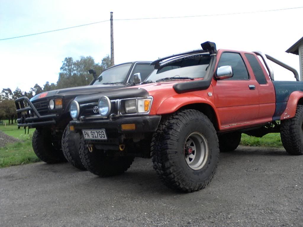

A friend's Arctic Truck on 35".
My brother's original Hilux 2003 (same chassis as Tacoma '97, just with a D4D diesel) on 31"

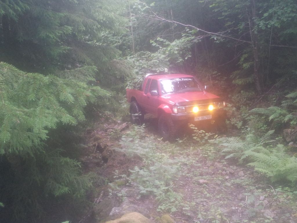

Had a few days off last week after a field trip so by those days 3 boxes from Low Range and Trail Gear got picked up with a letter from the register office. Installed a bomb proof gearbox mount and took it for a drive in the woods. I'll drive back home to night to have two weeks off. Preparing to paint the frame, tow hitch, rear axel and the drive shafts. Got the fender flares, but have to finish them up with paint and stuff before mounting. The US bed arrives this week and I hope to pick it up.

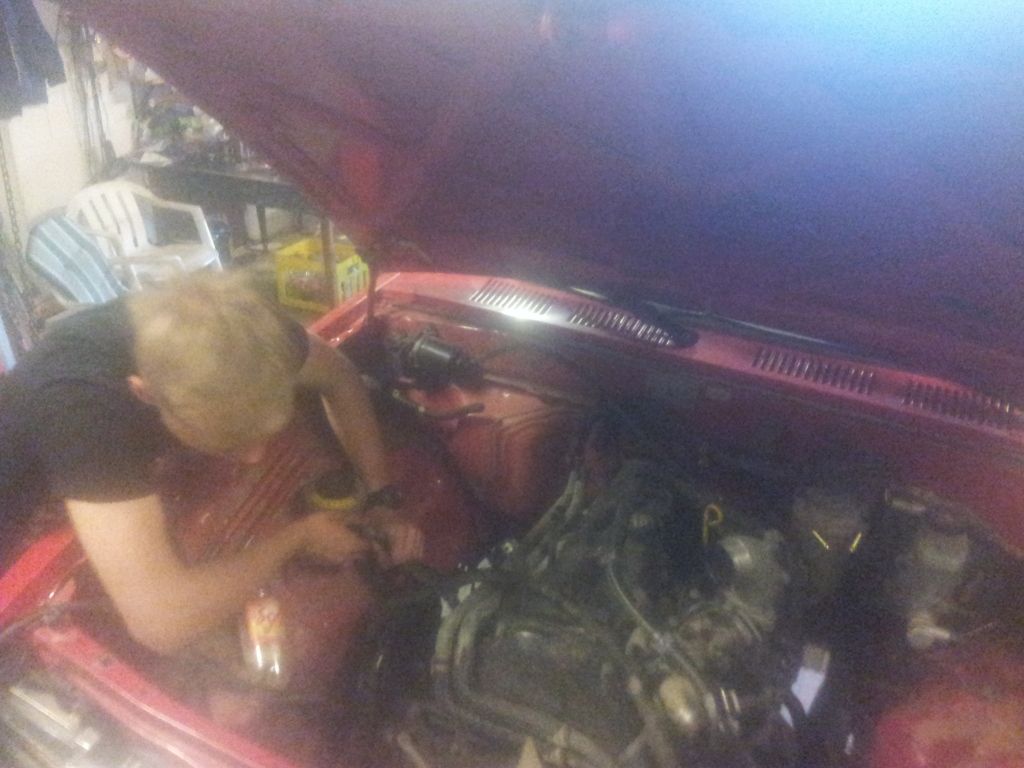

Next project, codename: engine swap
Had a few weeks earlier gotten the "new" engine out from my old truck and I got more and more tired of 82 horses struggling to keep the speed.
It's not much to write about this as it's just a regular engine swap on a Toyota.

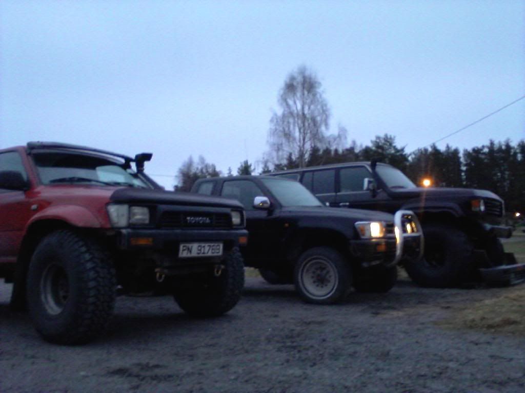

The last year not that much has happened. Bought a LC60 which has costed me a lot in parts and hours. Allthough I managed to change the bed a few days after the engine was istalled. The engine got new exhaust this summer. 3" downpipe and the rest in 2,5 inches. Began to make a new wire harness under the bed, but it just stopped.

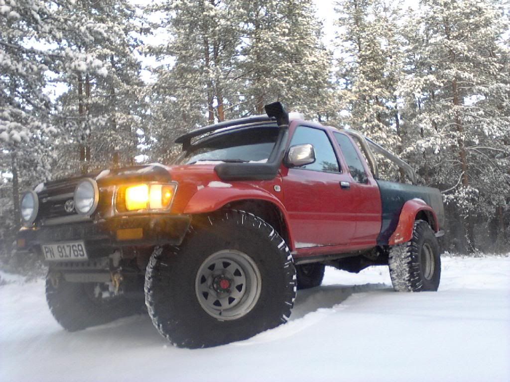

It was a lot more snow (20") when i picked it up, so you can call it a fun trip home after a half year without my old truck :wings:

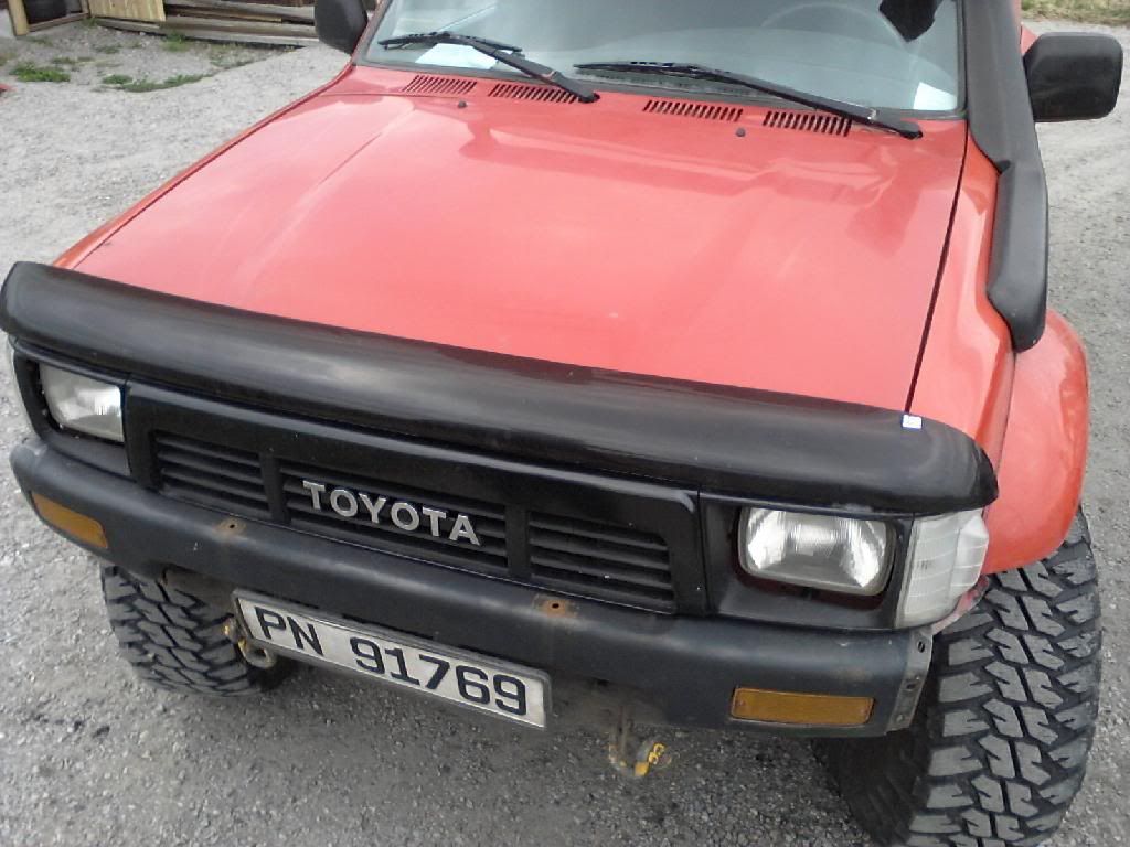

After a quiet and wet winter I figured the truck had to get some TLC and a little makeover.
Painted the bed and sold the chrome to a friend. Was more like a color coctail than an expo/overland build with the snorkel and gangster cap mounted. My mind went back and forth dwelling on what the exterior should be like. Like many men before me I figured that black is the way to go, and now it looks better. I'll let the pictures speak for themselves.
