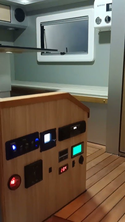

Small update on the trailer. Yesterday got my VIN for it and confirmed that it properly shows up on the NHSTA VIN decoder. According to the VIN this will be the 5th trailer from them going to the US or Canada. I’m a little surprised they haven’t standardized a North American version yet since I had to do a lot of 1:1 back and fourth about all the various plug, connector, and exterior lighting standards here.
One of their sales guys has a YouTube channel where he posts daily. My trailer made it into one of the reels and shows the interior nicely:
I’ll be doing a video call walkthrough of it with them in the next day or two and then it’s time to start planning the shipping.
