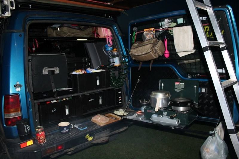

Is that a Mantec upper storage shelf (link) in the rear? I didn't think they made one for the Disco 1, but only for the Disco 2 according to their website. Not sure what the difference would be, though. Did it require any modifications to install in your D1? Is it a straightforward install?

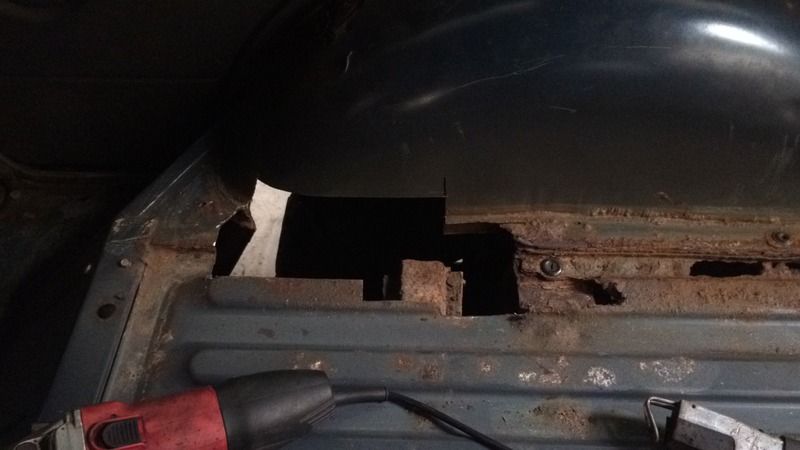

What approach did you take to repair your rear cargo floor? Any more photos of those repairs?
Any more photos featuring your rear cargo door panel and what looks like a fold-down table?

Hi there. Yes the rear shelf is the mantec job for a d2. All I did was fit it by eye. Rather than how the instructions say as they don't really apply. It's not difficult. All I did was use self tapping bolts. About 50mm atleast long ones that gave me the holes in the right place. Then inremoved the trim and drilled the holes out bigger and inserted rivnuts to take proper bolts. It's nice and solid up there now. The bolts that come with it are NOT long enough for the d1. And the shelf itself is a inch or so short. So out it together loosely before tightening the brackets to the Landy. This is the second one I've fitted to a d1.
As for the rear table I'll dig out some pics for you. It's a homemade job... Is there anything you want to see in particular?
The repairs to the rear were simple. Just cut out all the old rust. Replace with some panels of made. There wasn't to much. But it was enough to warrant doing the job. Fixed worse before just using a new floor.
This pic ^ I ended up making almost the length of the floor.
