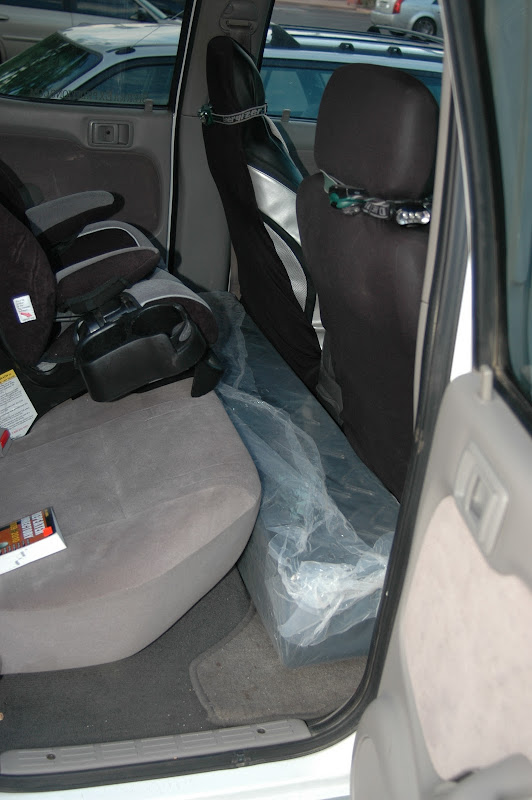

Any chance you can toss one of the foot wells in the back of your DC Taco and see how it fits with the seats in the middle to back position?
Here you go... Seats in driving position for me (5' 11"):

Here you go... Seats in driving position for me (5' 11")...
Right on, thanks Wil. So it looks like it sits nice and flat but the seats wouldn't be able to slide back anymore? I'm a couple inches taller but generally sit a bit forward comparatively. Appreciate you taking the time to do that!
Sits nice and flat... it obviously was in the shrink wrap, and the seat coul dhave gone back a notch or two... so I think you would be fine Kurt.

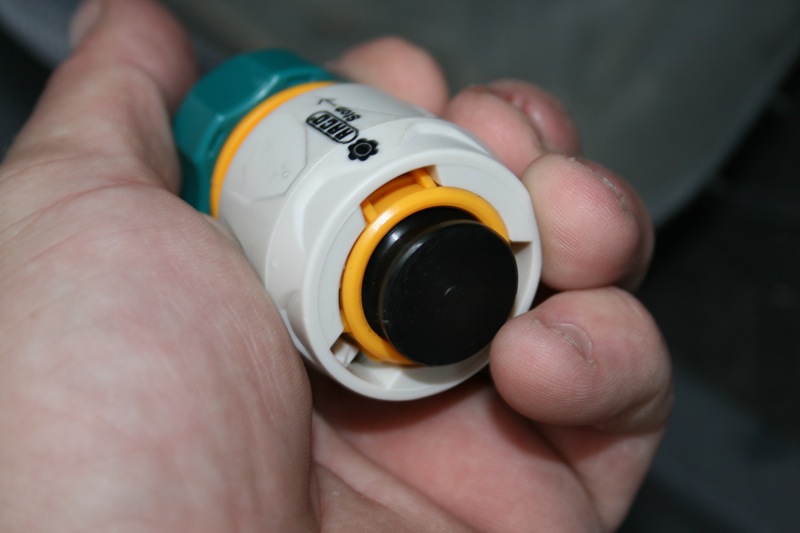

Ok guys, found the problem. I use the ACE brass quick releases for my helton setup, which are too big for this application.
I went to ACE today and found the ones you need for the quick disco on this tank...
$3.99 a two pack. Part# 72375 from ACE They're smaller diameter than the brass style.
adventureduo
Dave Druck [KI6LBB]
Alright, just got done water testing for leaks and putting the tank back in the rig. Also, i didn't use the metal hose holders yet.. i think i'll just keep them tucked instead. The flatter the hose is the slower the water runs and the tank seems picky. If you loosen the fill cap the water will flow faster.
Here's a few pics.. make sure to never loose the little black cap, otherwise the water will trickle out of the quick release slowly. I plan to pick up more of these.
