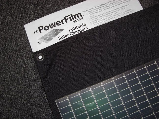

Can you tie the corners down (i.e.: grommets)?
Or would it work better with a velcro set up?
Thanks
Thanks
Dendy
Let me see if I can get some pictures today of what is already built in to the panel as far a grommets go.

There are 4 built in 1/4" grommets one in each corner of the panel.
