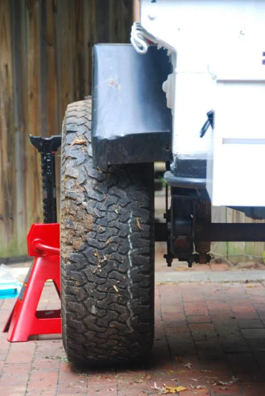

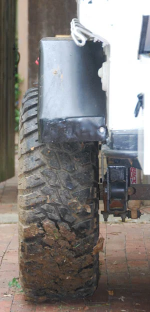

the backspacing was a big unknown. the hubs and wheels on my trailer before were (jeep) 5 x 4.5" steelies. the 6 x 5.5" sequoia/tundra wheels do need 1.25" spacers on my '80, and i only had 1 spacer left (i needed one for mounting my spare on the rear tire carrier :) ) so i sure was hoping to find i didn't need to order 1 more to get the 37" BFGs with tundra/sequoia wheels to fit my trailer.
turns out my fears were unfounded. the backspacing on the jeep steelies were much tighter:
steelies with 33" x 12.5 r15 MTR's: it's t i g h t
attachment.php
17" toyota rims with 37" x 12.5" tires:
more room even without spacers
attachment.php
so it all depends on what you're starting with.
